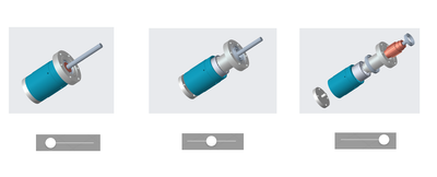

Hello
can someone explain me a procedure to perform a explode view using slider. 0-1 all the pars should move out to a predefined exploded position. should i write some code by using model item or we have an option to collect all model item at once and tag the postions. or anyhting in creo illustrate

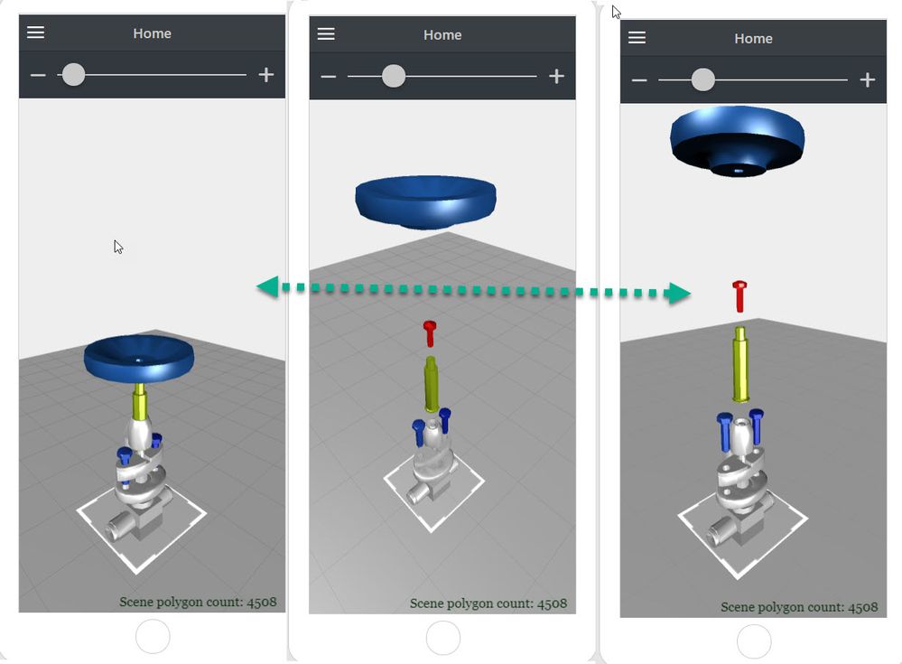

Hello @krthk86g ,
The first point is that  -
1.)you need to save all locaton e.g. if you explode in y direction
2.) you  can use the slider event to calculate explode state  e.g.  $scope.goSlider() function definition and call the  Value Change JS box of the slider widget
3.) you have to define a delta which is specific for each component - defined as extra modelItem widget
4.) calculate and set the y value of the modelItems which have to be exploded
Here is some very simple construct which should demonstrate the principle:
$scope.modelItems=[]
$scope.delta=0.5
$rootScope.$on('modelLoaded', function() {
  console.log("modelLoaded event");
   const args = Array.from(arguments);
  for( let  i=0;i< args.length;i++ ) {
    console.log("Event args["+i+"]="+args[i])
 for(let ii=0; ii <5; ii++) {
   $scope.modelItems[ii]={}
   let modelItemName='modelItem-'+(ii+1)
   $scope.modelItems[ii].name= modelItemName
   console.log("ii="+ii+" >> "+modelItemName)
   $scope.modelItems[ii].y=$scope.view.wdg[modelItemName]['y']
   $scope.modelItems[ii].delta= $scope.delta*2/(ii+1)
   // for simplificaton some automatic delta
    console.log("$scope.modelItems");
    console.warn($scope.modelItems);
$scope.goSlider= function ()
var slidVal=parseFloat($scope.view.wdg['slider-2']['value']/100)
console.log ("slidVal="+slidVal)
  let modelItemName = $scope.modelItems[ii].name
  //the sigh will convert the direction if negative
  $scope.view.wdg[modelItemName]['y'] = $scope.modelItems[ii].delta*slidVal*Math.sign( $scope.view.wdg[modelItemName]['y']) + parseFloat($scope.modelItems[ii]['y'] )
   console.log("$scope.view.wdg["+modelItemName+"][\'y\'] ="+$scope.view.wdg[modelItemName]['y'] )
The code above will move 5 modelItems in Y dirction where the delta for each component is calculated automatically for simplification reasons.
This code will move all components in the same time. You can make it more complicated where you can check if the value of the slider is in different range (if ... then block) but this will make it more complex.

1. In Creo Illustrate, create a Sequence with 2 Steps, a normal Assembly and an exploded one.
More details here about to create Sequence :
http://support.ptc.com/help/creo/creoillustrate/en/index.html#page/creo_illustrate%2Fgxy1370.html%23
More details here about how to create an Exploded View in Creo Illustrate :
http://support.ptc.com/help/creo/creoillustrate/en/#page/creo_illustrate%2FAbout_Exploded_Views.html
2. Export in pvz file
3. In Vuforia Studio, in your Project, import it
4. In 3D Model,  in Sequence Property, select the Sequence created previously
5. With a binding or with Javascript play the Sequence
By the way, with a slider, I am not sure if it will possible to control in real time, the Animmation steps and by side effect, the exploding positions of Components.

uploaded a demo project
