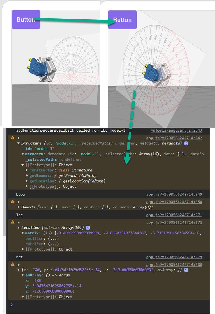

I've found some code to get the position of an assembly part here:
https://support.ptc.com/help/vuforia/studio/en/index.html#page/Studio_Help_Center/cad_structure_api.html
But it doesn't seem to work for me

I've added a demo experience to troubleshoot the issue.
Does anyone know what's wrong?

Hi @AlexK ,
possibly the project used old template. Also there was no meta .json file - at least I did not find such after I  imported the project to Vuforia Studio. So I  tested it ( with   Vuforia Studio 9.15)-
One point is that all the  parameter objects  should be an array from 3 items (also the scale) according to the PTC Studio Help.  so changed it e.g.:
 // Get the bounding box information for part '/0/0/2'
 var bbox = structure.getBounds('/0/0/2');
 console.log("bbox")
 console.warn(structure.getBounds('/0/0/2'))
 posArr=[]
 posArr.push(widgetProps.x);posArr.push(widgetProps.y);posArr.push(widgetProps.z)
 rotArr=[]
 rotArr.push(widgetProps.rx);posArr.push(widgetProps.ry);posArr.push(widgetProps.rz)
 scArr=[]
 scArr.push(widgetProps.scale);posArr.push(widgetProps.scale);posArr.push(widgetProps.scale)
 // Transform the bounding box to account for the 'model-1' widget's location
 var xform_bbox = bbox.transform(posArr,rotArr,scArr);
So now  it seems to work. Here the modified project attached to the post.
I think to get the (new ) functionality to work you need to start  with the latest version and create a new project. I did not  see this functionality  before. Because I remember that in previous    versions we needed to use an TWX extension to extract the bbox data . I remember that such requirement was reported as enhancement to R&D Team and now is really  good to know that it is already implemented in the current functionality !

Hi Roland
Thank you very much, your version works great! I did have to update my studio version to make it work.
