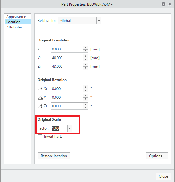

One of my requirement in AR is to scale up the model in between the steps. The scaling of the model has to be gradual when moving from one step to another. That is the model should not jump from one scale to another.
Avinash
You can also change the scale of the object in the sequence in Illustrate.
While in the Step Editor, just select the model you want and right click and select Edit Properties at the bottom of the menu and change the Original Scale Factor:
This change in scale will be recorded in the Keyframe editor so you can adjust the time if you want.
The pulse effect is just doing this by scaling up and down a couple of times.  You can get into the Keyframe editor and play around with the scale amount and timings if you want once you've applied the effect.
agangaiah
(To:AllanThompson)
Hello Allan,
Thanks. It worked 🙂
