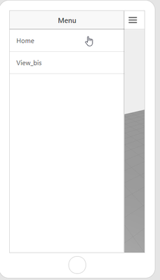

When I click the hamburger button in the header, it opens a side window with a Menu that only contains the word Home and all I can do is open and close this window. How do I edit this space to add/change the content in it and possible change the behavior (JS functions, buttons, text, etc). If I can't modify this space, is there a way to use the header but remove the hamburger button?
10 REPLIES 10
sdidier
(To:Sarahb)
This side window menu list all Views created in the Experience.
We cannot change it to add space or something else.
It is still possible to hide it and to create a custom menu to navigate in the Experience.

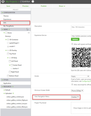

Steps :
  1. In Vuforia Studio, in the Project,
  2. In PROJECT panel, in CONFIGURATION section, in Info menu
  3. Switch off the View Navigation Menu checkbox

How do you create a custom menu? Also, when I switch the navigation menu to hidden, it goes away in the preview, but is still there once I publish. Is there something else I can do to hide the menu?

I am unable to send you the project because I'm not allowed to share my work. I just checked again, and although I set the navigation menu to 'hidden', the header and hamburger button (with the menu of all views) is still there in the preview and when published.

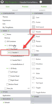

  • Can you confirm that the Header Home Menu described is similar as in this screenshot ?Vuforia_studio_home_menu.png
  • By the way, it is possible to have the same result by using an Header widget, also.
  • Are you using also this Widget in your 2D View ?
Also, please find attached an example Project with the same settings as described in this thread.

Yes, the header home menu is the same, and yes I used the header widget. When I open up your project, the menu is still there even though the settings are set to hidden, so I may be misunderstanding what should happen when the navigation menu is hidden.
sdidier
(To:Sarahb)
Hello Sarah,
By default an Header menu is present but not included in View.
Using the View Navigation Menu checkbox is hidden it.
If a Header is added in 2D View, it is displayed event the value of the View Navigation Menu checkbox.
Best regards,
Samuel
