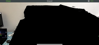

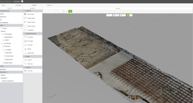

Following Article CS325947,  I was able to import my 3D model (obj) with its texture (defined by mtl file), as shown. However, after I published my project and view the model in View experience ๏ผˆthrough spatial target), the texture is not able to display properly (as shown). How do I go around this issue? Is there anything I missed out?
3D model with texture displayed properly in Vuforia Studio
Texture is not displayed in View

This seem to be the answer to your issue
https://community.ptc.com/t5/Vuforia-Studio/3D-images-are-not-visible-in-vuforia-view-IOS-devices-only/td-p/711895
Basically you have to resize the texture to make it smaller.

Thanks! It is the exact solution I was looking for! ๐Ÿ˜€
