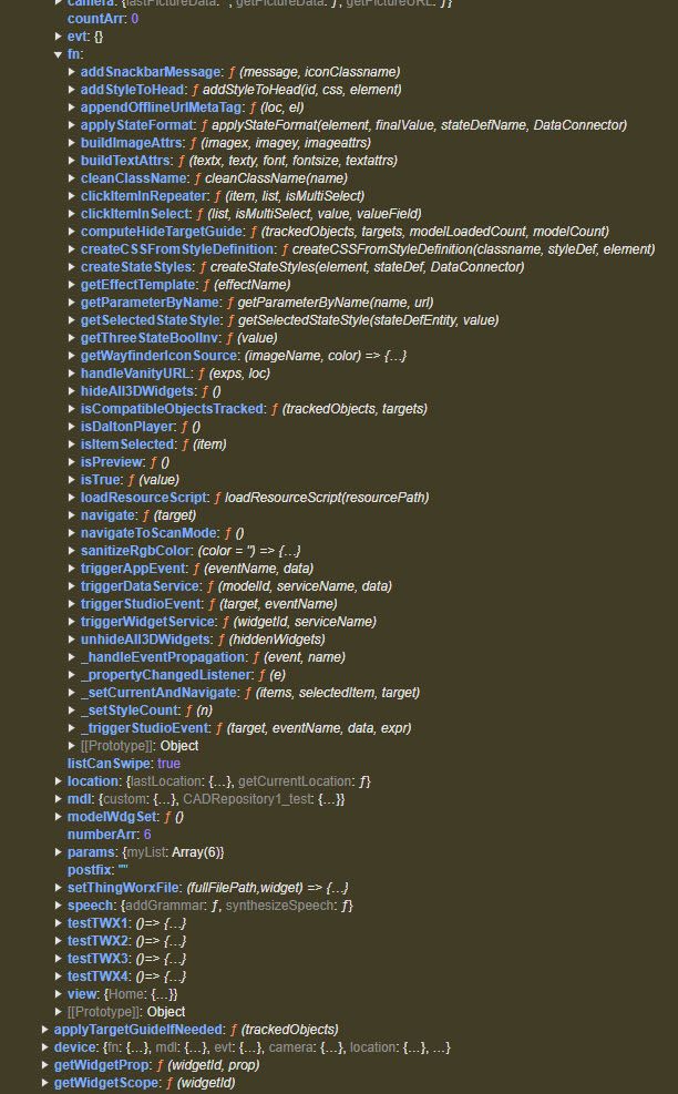

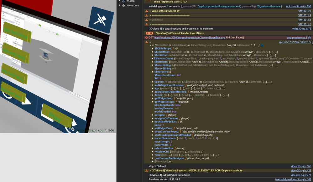

So printing the scope e.g. :
angular.element(document).ready(function() { console.warn($scope);})
and then in preview checked in the Cntrl+Shift+I debuging console check the $scope but the printing does not contain such function :
also checked the $scope.app.fn object
here also could not find any function with that name by default function of eyewear project.
Ok when I define a function e.g.
$scope.goToLibrary = ()=>{
//... you go2library definition here
then you will find that in the $sope object.
Are there any specific extension installed. Possibly function is defined by extension or by some loaded javascript module?
Also,could you check, please, your Home.js or any <view_name>.js - in the project where you find that function if there is a javaScript defintion of that. It will be interresting what that defintion implement. Thanks
