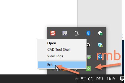

  • If you  want to set the thingmarks in the Project - Menu : My Project > currentProjectName > Configuration > My ThingMarks. And you want to  set  it generally for all new VuforiaStudio projects.Copy the new thingmarks to .Documents\VuforiaStudio\ThingMarks folder bild1.jpg
  • Modyfy the ...Documents\VuforaStudio\builder-settings.json (but first do backup copy of this file!!!)  file by adding some thing like (relevant new part in orange color):

  • Important when you save this file you need to restart Studio. But if the Studio process is still active it will override this setting and you will see the old setting. In order for it to not overwrite any changes you make in that file, kill Studio first then make the necessary changes. On Windows, in the system try there should be an icon for Studio, right click on it and exit to fully kill Studio.
  • Now when you restart studio you will see your new thingmarks in “MyThingmarks"
  • And all thingmarks will be available in the thingmark list2018-09-20_11-25-35.jpg
