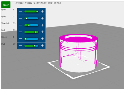

I want to display the model by Wireframe in Vuforia Studio.
According to PTC's confirmation, it does not support wireframes, and there are no plans to support it in the future.
I want to use Shader for wireframe display. Does anyone know a sample or how to make it?
I've already tried XrayShader, but my client wants a full wireframe display
Best Regards.

Thank you for presenting the information
I'm trying, but I haven't done it yet.
The TML text of Vuforia Studio only describes the vertex shader and fragment shader. Is this feasible?
It is the content that I am trying variously
I'm aiming for a look similar to a wireframe, but it's a little different.

<script name="Xray" type="x-shader/x-fragment">
 precision mediump float;
varying vec3 P;
varying vec3 N;
varying vec3 I;
varying vec3 vViewSpaceVert;
varying vec3 vViewVector;
varying vec3 vNorm;
 uniform float r;
 uniform float g;
 uniform float b;
  uniform float thre;
  uniform float opa1;
  uniform float opa2;
  const float edgeFalloff = 0.8;
  const float intensity   = 1.0;
  const float ambient     = 0.2;
  void main() {
    vec4 color     = vec4(r,g,b,1.0);
   float opacity  = abs(dot(normalize(-N), normalize(-I)));
opacity = abs(opacity);
 //   gl_FragColor   =  opacity * color;
if(opacity<thre)
gl_FragColor   = vec4(r,g,b,opa1);
gl_FragColor.a=opa1;
else
gl_FragColor   = vec4(1.0,1,1,opa2);
gl_FragColor.a=opa2;
 </script>
