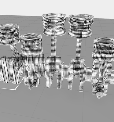

I'm aiming for a look similar to a wireframe, but it's a little different.
<script name="testShader2" type="x-shader/x-fragment">
precision mediump float;
varying vec4 vertexCoord;
void main() {
float sinx = sin(400.0 * vertexCoord.x);
float siny = sin(400.0* vertexCoord.y);
float alpha = step(0.85, 1.0 - abs(sinx*siny));
vec3 black= vec3(0.0);
gl_FragColor = vec4(black,alpha);
</script>
