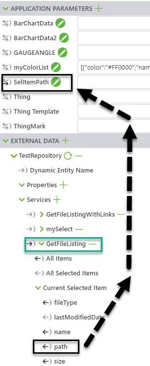

Hi @Velkumar ,
thanks for clarification! But first I need to point that there is  a little a mix-up.
That what you are asking, I believe, it is not about a thingworx event but this is an event based on the twx data which has binding   to a particular Studio widget. That is the event which based on the selection in UI when selecting an item of  the widget. So, when a service does not have binding you will see that this element are empty / or do not have any values
So the question here is how to track the event / the select on the Studio side

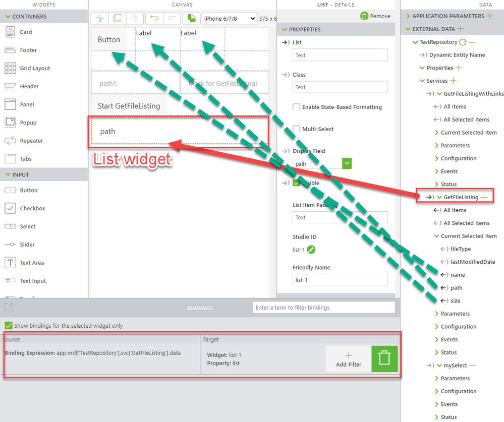

Let consider here an example with the service GetFileListing (Repository Thing) :
So, we can bind the service e.g. all Items - to a list property in a list widget and the different selected items to another widget / to the text properties:

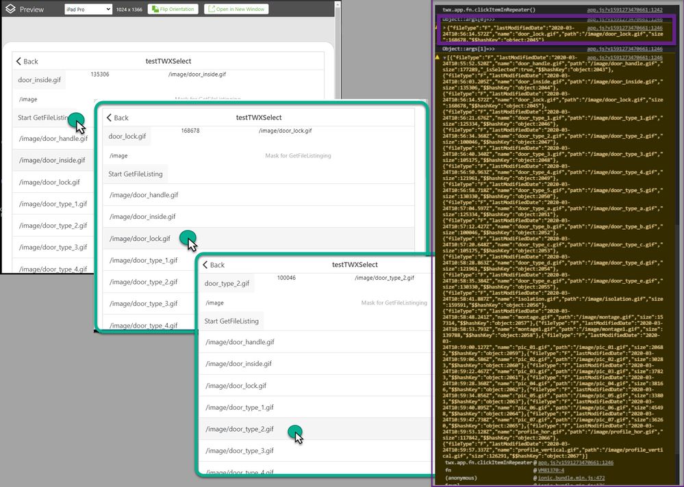

When  we test it we will get on select the value in the different widgets as shown:
One possible thing is to read simple these values also in case if they are not visible. Possible is to bind them to an parameter ( or you can bind directly the Current selected Item of service to an application parameter and track the parameter change via the $watch construct:
$scope.$watch("app.params['SelItemPath']", function (newValue, oldValue, scope) {
console.log("Old Value -befor it was changed =" + oldValue);
//! it could be undefined first time called
console.log("new  Value -after it was changed =" + newValue);
//prints the current $scope (copy) object passed to the $watch construct
// pay attention it has no $ !
console.warn(scope);
 But of course you can use the twx.app.fn.clickItemInRepeater() callback what you can defined in the javaScript of the view (e.g. Home.js). When we click on the item the sample function will print to the console as shown in the picture above
twx.app.fn.clickItemInRepeater = function()
  console.log("twx.app.fn.clickItemInRepeater()");
  const args = Array.from(arguments);
for(i=0;i < args.length; i++)
    { if( isObject(args[i]) )
    		{console.log("Object::args["+i+"]=>>"); console.warn(JSON.stringify(args[i]));}
      else
      		{console.log("primitive::args["+i+"]=>>"); console.warn(args[i]);}
Here the first argument (args[0] ) contains as object (json) the selected data set

Thanks @RolandRaytchev
Solution works perfectly.
