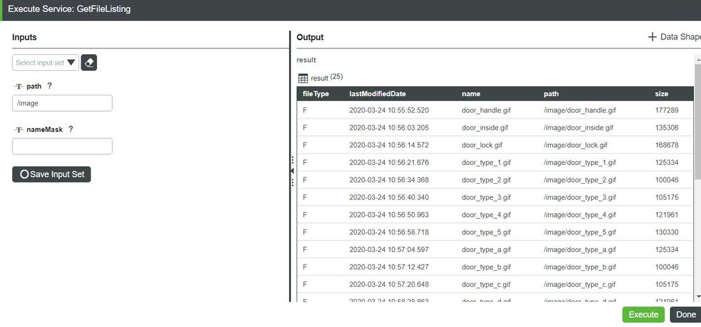

June 4, 2020
Hi @Velkumar ,
thanks for clarification! But first I need to point that there is  a little a mix-up.
That what you are asking, I believe, it is not about a thingworx event but this is an event based on the twx data which has binding   to a particular Studio widget. That is the event which based on the selection in UI when selecting an item of  the widget. So, when a service does not have binding you will see that this element are empty / or do not have any values
So the question here is how to track the event / the select on the Studio side
Let consider here an example with the service GetFileListing (Repository Thing) :
So, we can bind the service e.g. all Items - to a list property in a list widget and the different selected items to another widget / to the text properties:
When  we test it we will get on select the value in the different widgets as shown:
One possible thing is to read simple these values also in case if they are not visible. Possible is to bind them to an parameter ( or you can bind directly the Current selected Item of service to an application parameter and track the parameter change via the $watch construct:
