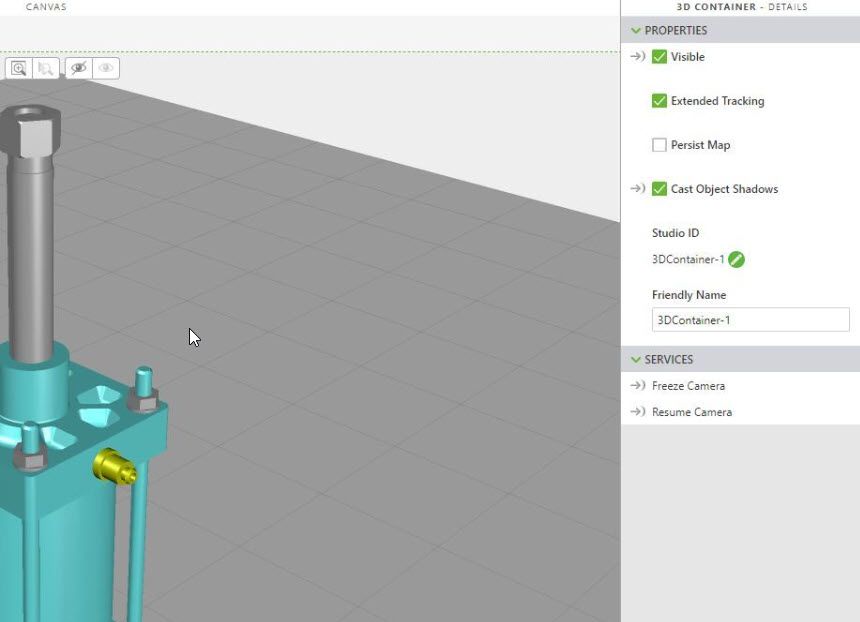

    I'm trying to get postion of my camera (On Hololens 2) with this code:
$scope.setVector= function() {
tml3dRenderer.setupTrackingEventsCommand (function(target,eyepos,eyedir,eyeup) {
$scope.app.params.eyepos = [eyepos[0].toFixed(2),eyepos[1].toFixed(2),eyepos[2].toFixed(2)];
$scope.app.params.eyedir = [eyedir[0].toFixed(2),eyedir[1].toFixed(2),eyedir[2].toFixed(2)];
$scope.app.params.eyeup = [eyeup[0].toFixed(2), eyeup[1].toFixed(2), eyeup[2].toFixed(2)];
$interval(function(){ $scope.setVector(); },100);
Obviously, the three values of "eyepos", "eyedir", "eyeup" are mapped with parametre which are linked to a "3DLabels" Widget to display values within my experience.
In the two tests, I'm using a "Thingmark" to activate my experiences.
And  I'm facing some issue, this code is working fine on "Mobile Project" but on "3D Eyewear"
Any ideas ?

Hi @Lionel_Brly ,
so far I remember in the post was metnioned the usage "How to get camera position?"
I have only the HoloLens1 but there is no principle difference from the studio side - so that eyewear project should work on both. I will check if I have such project as demo - so far I remember it was working fine when I tested it on the HoloLens 1 some week ago
What I do not think that is a good idea – is to call the setVector function in an interval. The tracking event has it own callback.
June 23, 2020
in the article "How can we make a 3D Widget on HoloLens visible in front of me every time ?"  I uploaded  an project which is handle  more complex but it used the requested functionality for tracking of the device postion - so you can check it
Another info which could be helpful is this one : "https://community.ptc.com/t5/Vuforia-Studio/Finding-distance-from-the-model/m-p/647473#M7497"
In the both mentioned link I attached a project which should demonstrate the functionalit and it implies the requested functionality
In the last post , the more relevant information to your issue is this below:
when I open a project it is always there / HoloLens and Mobile/
- the option 'Enable tracking Events' is threre
I checked my Vuforia Studio builder-settings - at the end I added the following options:
 "enableDebugLogging": true,
 "publishPreview": true,
 "welcomeDismissed": true,
 "designTimeDropShadows": "HARD",
 "projectsListView": true,
 "annotationsEnabled": true,
 "serverMTG": true,
 "showTrackingEvents": true
So belive the option "showTrackingEvents": true has relevance for the mention  display in the 3d container widget UI.  but may be in combination with some of the other options.

In the parameter eyepos, eyedir and eyeup I created binding to the text property of the lables label-dinstance-x/y/z and are displayed there.
I attached the test project in the mentioned post
July 10, 2020
Hello Thanks for your reply,
  This code is running veru well!
Lionel
