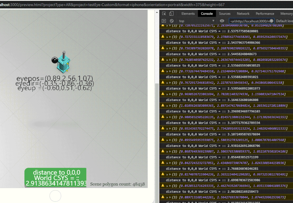

Hi @vivekse ,
yes, this this is correct.  I checked it in a mobile project but it was not working stable.
So,I tested somethings furter and have now a mobile project where it seems to work now - means you will received the coordinates of the eye positon , gaze vector and the up vector.
I tested in preview (this is only simulation for mobile device- so that the results/values are not relevant) but I tested it also on IOS Ipad6 and was working with the current Vuforia Viewver version:
the code :

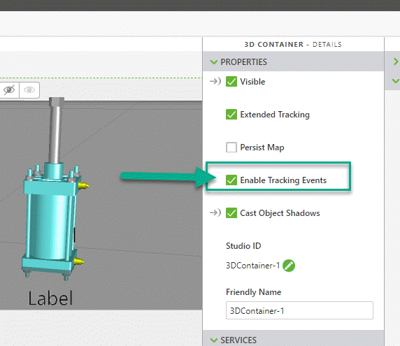

$rootScope.$on('modelLoaded', function() {
 $scope.setWidgetProp('3DContainer-1','enabletrackingevents',true);
 console.log("now check again the setting of the envronment")
 console.warn($scope.app.view.Home.wdg['3DContainer-1'].enabletrackingevents)
 //// end of modelLoaded

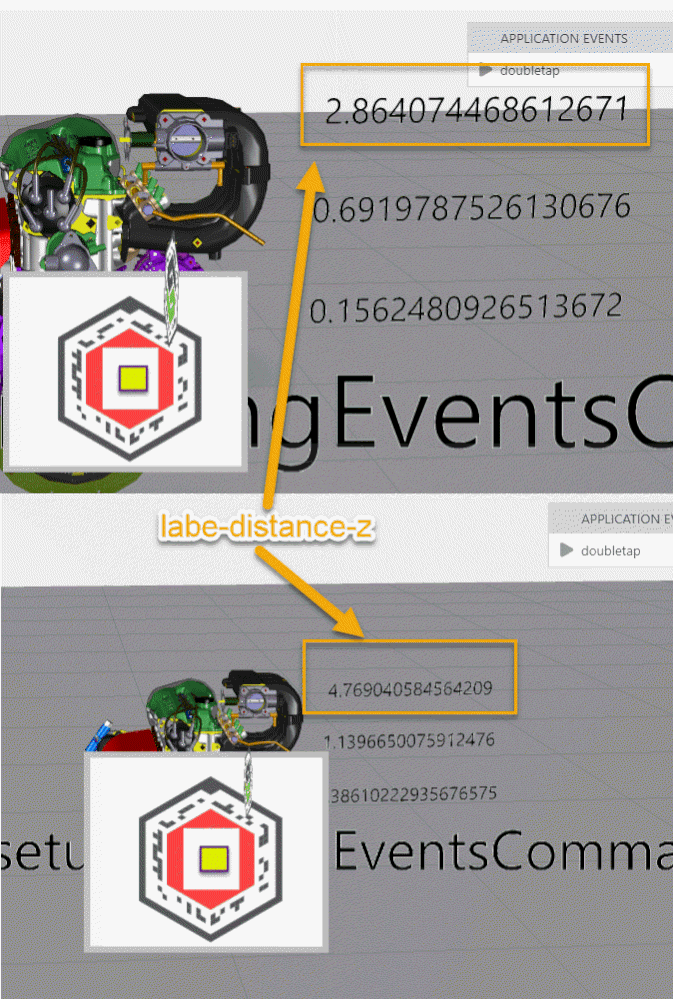

 console.info("distance to 0,0,0 World CSYS = :: "+magnitute(fargs.position[0].toFixed(2),fargs.position[1].toFixed(2),fargs.position[2].toFixed(2)) )
 $scope.$applyAsync();
In the parameter eyepos, eyedir and eyeup I created binding to the text property of the lables label-dinstance-x/y/z and are displayed there.
I attached the test project
