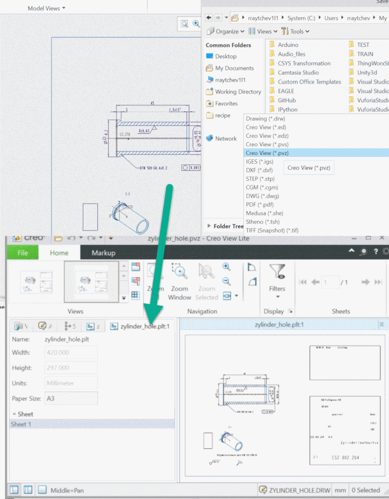

there currently does not exist an intended process for displaying of drawings in Vuforia Studio/View. The design approach there is to show light ware geometry as 3d - using the pvz format.
Actually, the pvz format could also contain some 2d drawing geometry as viewable files.  This means that you can review a pvz containing drawing in Creo View and it will display the drawing there .
In the picture above we can see that the pvz file contains a plot of the drawing /plt format
But so var I know this will not work in Vuforia. I will test this to be 100% on the save side and will provide a feedback if this will work.
currently we need to convert /as you already try/ the drawing to a picture / raster format/ or to SVG vector graphic format. There is no special way designed, so far I know; the problem that this may be does no work on particular devices is that there could be the different availability of the different platforms to handle images/ especially if they required more system resources, also the different platforms could support different formats and maximum of file size which could be displayed in an app

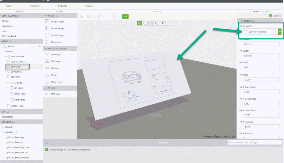

I tested but with small drawing and it was working on i-pad 6 generation
-in Creo parametric open a drawing and saved it as png file. This is not the best way. Better is to print and configure an raster printer so you can setup which size and dpi etc. But for the general test is ok
-now created a new project with 3d image.

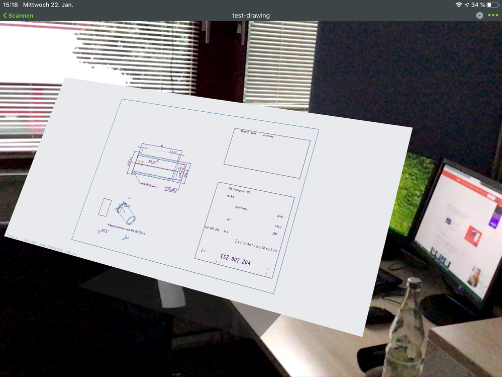

Now I published the project and scaned with  Vuforia view on   IPad
It was working. I also expected this behavior because the 3d Image do not make difference if the picture what you want to display is drawing or anything else. The only thing which may be, here could cause a problem if the picture is to large sized for system capability of a device
