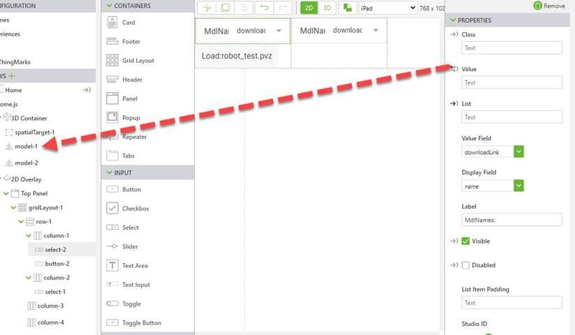

I am setting up pvz resource retrieval directly from thingworx. Here I'm facing a problem with the location of the thingmark.
On the one hand, in a Vuforia Studio experience created with directly uploaded resources the thingmark can be anchored and sized on the "real" surface of the model, but, on the other hand, if the resource is remote (thingworx repo) this does not seem possible.
As the VFStudio guide says
<<Use a ThingMark when:
• You want to align your physical object and digital model as closely as possible. In order for the 3D model to display in the correct location, you must place a digital ThingMark in the same location as your real-world ThingMark. >> This is exactly what I want, but I need to load remote resources.>>
Is there an option to preview remote resources also in the 3D development area?
Best answer by GianVal
Ok i found that this is not possible. The preview in vuforia studio will never show the model of a remote resource. For thingmark placing is preferable to open a local copy of the model, place the thingmark in the right position and that remove it.

I think previewing remote resources in the editor is not possible.
To align you models to a ThingMark you probably need to load the resource in the editor, align it, copy the position and rotation and use it then for you remote resource.

I aggree with the statement of @sebben  and want  to add possible workaround. So when you have for example a CAD repository thing containing in some folder many pvz files and you want to review them so see how they looks like- in this case you can use some auxiliary project which could be started in preview mode and there via list you can select any files of the list to display how they looks like.
To create some proejct you need e.g. the following steps:
  1. create a new   Thing e.g.  named “CADtestRepository” using the template FileRepository
Set permission according to  http://support.ptc.com/help/vuforia/studio/en/#page/Studio_Help_Center%2FGrantUserPermissions.html and http://support.ptc.com/help/vuforia/studio/en/#page/Studio_Help_Center%2FAnonymousAccess.html%23  on the TWX server  and also added the CADtestRepository for the service GetFileListingWithLinks  -visibility and service runtime execute permissions for the es-public-access-org
        2.) Add  aservice GetFileListingWithLink to a Vuforia Studio project – external data section – execute on load
        3.) Link  all items of the service to the List property of the Select widgets
         4.)Set the property "value" of the select widget (example for select-1 ) which is already  linked to the GetFileLsitingWithLinks srv /all Items (create a binding to)   to the model widget resource (src) property (please , see picture below)picture-1.jpg
       5.)So, now we have select widget/s  where the list property is linked to the External Data service , all Items of service GetFileListingWithLink – Thing  “CADtestRepository”. The  select widget/s has a binding of its “value” property to a separate model widget to the src /resource property , please see the picture below:
   So then we can test the project in the preview mode
