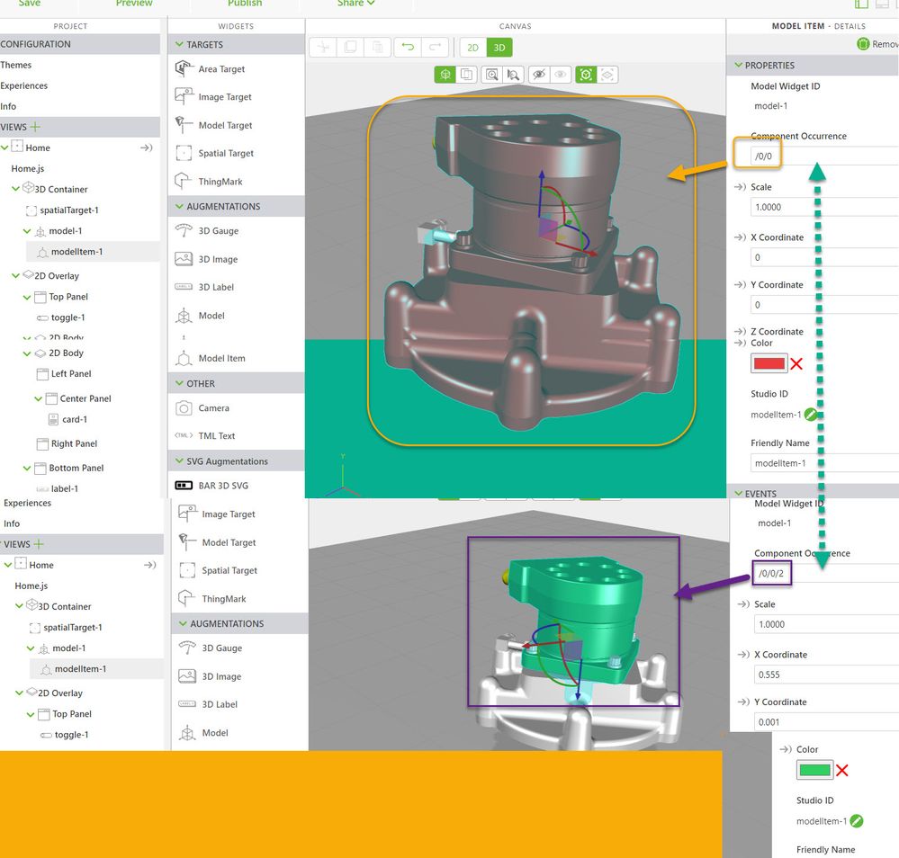

Hi @miurat ,
so when you define a modelItem widget then you can select the item and possibly this will select
Model Item A: 3/4/5
or
Model Item B: 3/4/6
To combine both is ok then to go to the Component Occurrence attribute of the modelItem widget and change it to 3/4 manually - which means that this will refer to the subassembly one level above. Mostly this should work. So far my experience this will work fine when you define this first time and some time later UI will not accept this change . In this case you can delete the modelItem widget and recreate it by updating the property as desired.
Example (not the best because actually 0/0 is the root assembly when model was published in Creo Illustrate ) to show the general principle
