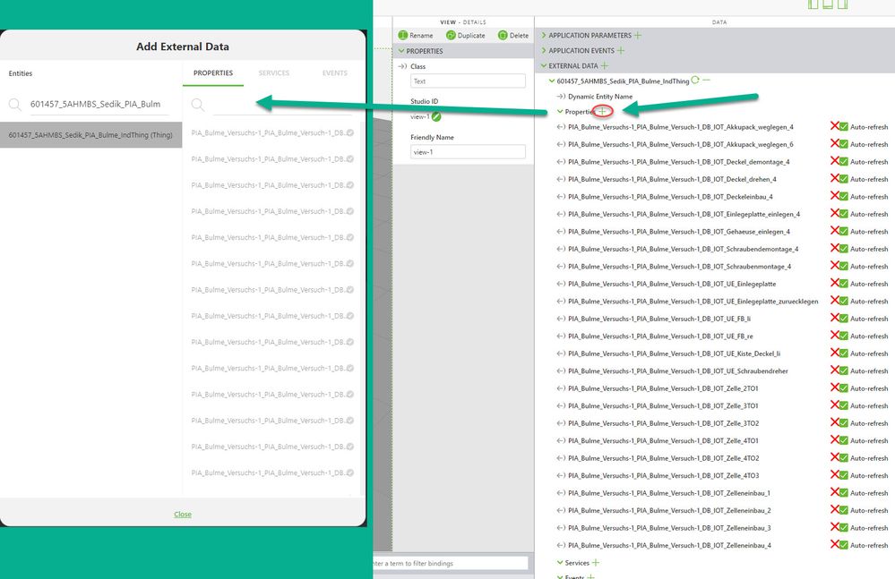

We control our assembly instructions in Vuforia Studio with parameters
that we receive from a Siemens controller via KEPServerEX.

the code I provided what splitted in two part to insure that when a sequence is set to modelwidget  then it will play so for the case that  i it requires a long time to load .
But one time sequence is set on Modelwidget it could be play many  time you start the play service. So when the code is called - /when I mean code it is only the part I provided h / and you have a 3D button which has a binding to the play service of the widget e.g. 'model-1' this always should play -so simple button binding to modelwidget  without any codes only
