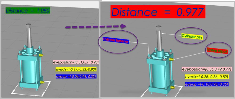

Regarding to the point 2.) in your post:
It is not easy and need to adjust each leader and 3d Notes. But when I see the video, I think the notes with leaders are not dynamically in the most case. In one case where the leader line is coincident with the pivot axis of the text - there could be used also the billboard property of the 3DLable. The other cases are simple combination of 3d Image /for the leader line/ and 3DLabel text.
Here in the example we have the effect that the leader lines will apper "automaticaly" -> in this example when we gain a distance < 1 meter to the point [0,0,0]. But it could be any points which should be in the middle of a particular component. So that it is a distance ball around specific component
