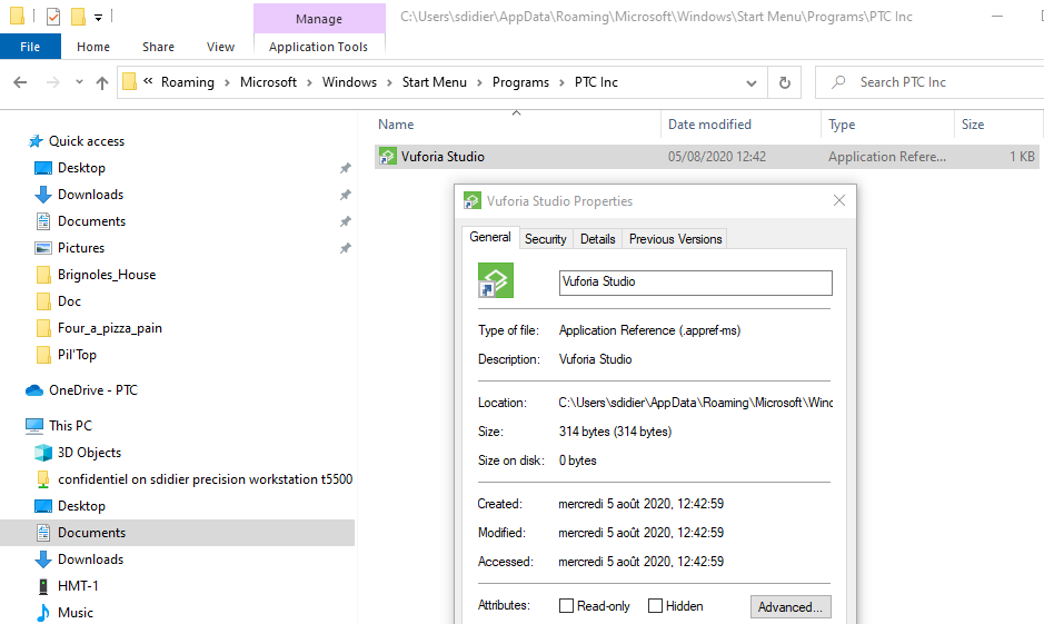

  • In %USERPROFILE%\AppData\Roaming\Microsoft\Windows\Start Menu\Programs\PTC Inc  folder, it is an application reference to Vuforia Studio. it is like a shortcut.VuforiaStudio_Shortcut_folder.png

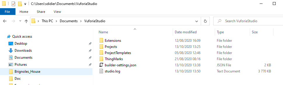

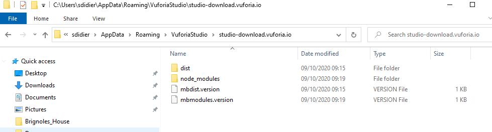

  • In %USERPROFILE%\AppData\Roaming\VuforiaStudio\studio-download.vuforia.io folder, we have Vuforia Studio data files. VuforiaStudio_application_folder.png
  • In %USERPROFILE%\Documents\VuforiaStudio folder, we have the personal data and Projects created
    locally.
  • Can you confirm that we have similar results in your desktop, please ?

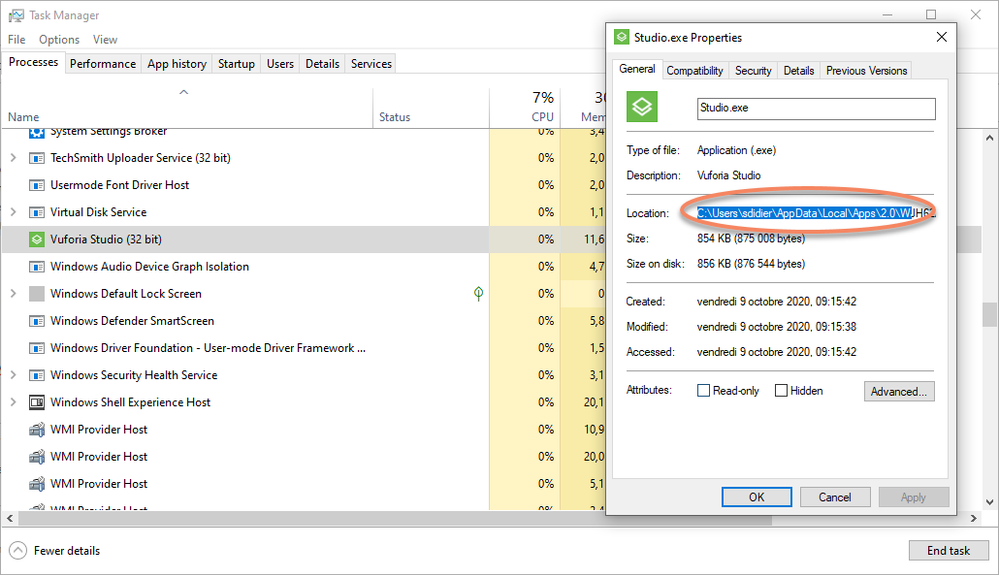

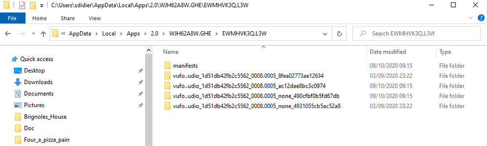

By the way, the .exe Application location can be found by using Task Manager.
This path has this format : %USERPROFILE%\AppData\Local\Apps\2.0\<RANDOM NUMBER>\<RANDOM NUMBER>\vufo..udio_<RANDOM NUMBER>
It is the folder where we can find application itself.
For example, in my workstation, we have :
  • What do you have in this folder ?
  • What is the size of this folder, please ?

Hello @sdidier,
Yes i made a mistake i have the same things as you in the 3 differents folders. I have this in my workstation
The size of the folder is 375 Mo.
Best regards,
Thomas

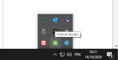

        1. Shutdown Vuforia Studio:
                    a. In Windows task bar, click the ^ icon to expand it
                    b. In this frame, found Vuforia Studio icon
                    c. Right click on it
                   d. In popup menu, click Quit menu

      For step 1, I suppose icon is not present.
      For step 2, I suppose also that these processes are not present. Be carreful, if Vuforia Experience Service is installed on this Windows computer, a Node.js: Server-side JavaScript process should be present also for this product.

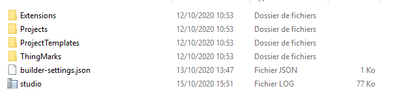

  • What is the real full path of %USERPROFILE%\Documents\VuforiaStudio ?
  • What do you have inside it ?
  • What are the permissions on it ?
  • What is the username used to log on in Windows ?
Best regards,
Samuel
Hello @sdidier ,
  • The real path is C:\Users\t.boulay\Documents\VuforiaStudio
  • I have admin permission
  • My username to log is t.boulay
  • Here a screenshot of the path VuforiaStudio
Best regards,
Thomas
