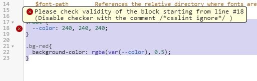

Hello friends,
is it possible to configure the Vuforia Studio to support native variables in css?
Something like this:
:root {
--color: 240, 240, 240;
.bg-red{
background-color: rgba(var(--color), 0.5);
In present time must write unnecessarily complicated code because:
thank you for every post.
Tomas

Tomas,
I'm not sure CSS Custom Properties (native variables) can be used in Studio, however you can include SASS syntax in the Application STYLES file: the file will be built to a css file using a SASS processor.
So, you can do something like this:
$color: rgb(240, 240, 240);
.bg-red {
  background-color: $color;
  opacity: 0.5;
The CSS Custom Properties syntax is flagged by the parser as incorrect: I can't say whether that's just a parser issue or the processor itself doesn't support it.
