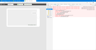

I am able to get it display but only animation is not working. Capture.PNGPlease find above image for error reference.
jmikesell1-VisitorAnswer
June 17, 2019
So if you read that last error saying "anime is not defined" I would start there. I don't see 'anime' defined anywhere in the code you posted, but you try to reference it in the first line.
