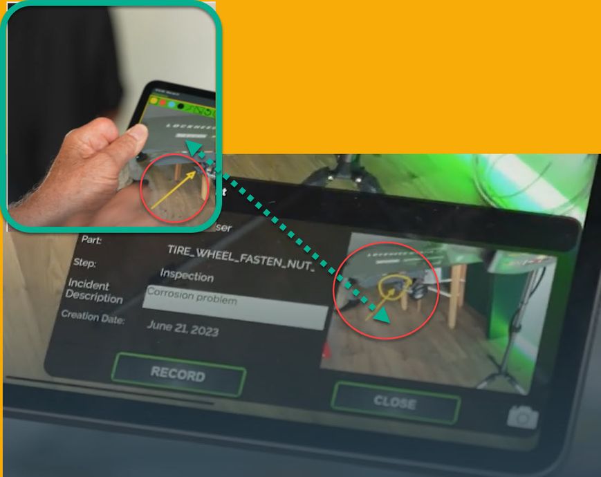

Dear Community
I've just watched a video about a F35 demo, that was presented at the Paris air show.
It includes a picture markup function (added screenshot), that would be a great addition for inspection use cases.
Could this experience, or just the code be shared here?

Hi @AlexK ,
It is important to know what is the possible business case and the requirement in your particular application case if such applicaiton is planed next time /or if you have some specific customers’ requirements
I want to point that this functionality is working fine in the Vuforia Chalk on video conferencing there but not availible in Studio yet. Depending on the your application case possibly you can use vuforia chalk instead.
I reported this requirement now to PTC R&D as Jira Ticket VTS-1876 as enhancement request

Is there any news regarding the Ticket?
We have a customer interested in making annotations.
Best wishes
Alex
I checked the ticket VTS-1876 and VM-77 but unfortunately there is no informaiton about what of new functionality we can expect and when it will be released. Therefore requested update on the both ticket. I will let you when there is R&D feedback to that tickets. Thanks

Hi Roland
Visualizing the CFD-model is very cool, but the use case that I have in mind needs the markup functionality. Example: the user draws a circle around an issue in a inspection and the person who has to fix it can access this information at a later stage.
It is shown in the screenshot in my original post here.

Alex, I checked it further e.g. the functionality:
So when you post that question I reported that as a Jira Ticket VTS to R&D team VTS-1876. So checked now the ticket an it seems that this functionality is not part of the product currently. So the team what developed the project /PTC Vuforia Velocity team has some specific developments which is not shared internaly. So possibly the dev could share some points but you need to address your quesiton directly on the channel where the video is posted so - e.g. the option ask a question which will be address to the vuforia velocity team.
So regarding to R&D answer:
R&D will keep this as an feature request.
For now, I think we can do two things:
1) We are working on an API update on the userPick event that will return the actual picking point and normal-vector. With that an experienced experience creator might be able to add annotations at runtime to the 3D object and display them directly there.
2) Maybe we can publish the example code for the picture markup as it was used in the demo within our help-center, so that customers are able to recreate it themself.
The product team added the improvement request to their backlog and used the newly created and linked ticket for prioritization. Questions could be asked in this ticket
The new Enhancement Request ticket is VPM-77 -status is still under development.
I think point1 is already implemented in the current release. Usepick has the coordinates of the click - so we move a donut part e.g. to have a markup - that point where to clicked (userpick) that is one simple solution what comes to mind first . please refer to https://support.ptc.com/help/vuforia/studio/en/#page/Studio_Help_Center%2FAdvanced_Geometric_Mapping.html
Point to 2 is not implemeted yet. But we can use some drawing - svg format - on the current Canvas panel. something like that https://developer.mozilla.org/en-US/docs/Games/Tutorials/2D_Breakout_game_pure_JavaScript/Create_the_Canvas_and_draw_on_it
But it could be a device specific soluton - probably not working e.g. on HoloLens 2
