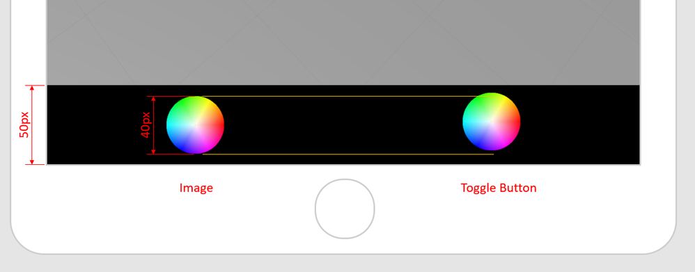

I've noticed that for some reason, toggle buttons have a bit of extra space below them.  This can cause alignment problems when placing them in a grid.
Most experiences I create have a toolbar along the bottom of the screen with various "buttons".  These buttons are usually either an image widget with some JS function called on the click event, or a toggle button to turn things on and off.  The extra size of the toggle button means that is doesn't center vertically within the grid.
The screenshot shows what I mean.  I have a grid layout with a single row and a single column.  The row is set to 55px high and the column has Flex Direction set to Row and Alignment set to Center.  When I put an image and a toggle button in and that are both set to 40px x 40px, the image is vertically centered, but the toggle button isn't:
When in the editor, you can see the extra blank space below the toggle button when you select on it.
I often have a row of buttons that are a mix of images and toggle buttons and this mis-alignment doesn't look great.  Any ideas on how to fix this?

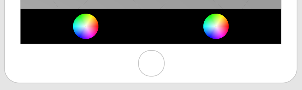

How it looks with the v-middle style applied to the toggle button:
