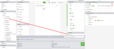

  • Create an Application Parameter by clicking + next to Application Parameters. The app param value is a JSON formatted array. For example.
    • [{"val":" l-Creo 3D - Figure 1.pvi"},{"val":" l-Creo 3D – Figure 2.pvi"}] Screenshot_13.png

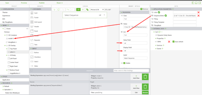

  • The object attribute name val must be specified in the Value Field and Display Field properties of the Select widget.

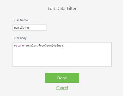

  • The app param is then bound to the List property of the Select widget. This binding has a filter on it with the following expression:
  • Bind the Value property of the Select widget to the Sequence property of the Model widget
  • Now, put the PVI file name in as the default ‘value’ for the select widget as shown below:Screenshot_12.png

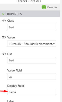

  • To change the display name in the list, update the array in the Application Parameter as follows:
    • [{"val":"l-Creo 3D - ShoulderReplacement.pvi", "name":"ShoulderReplacement"},{"val":"l-Creo 3D - ElbowMotorReplacement.pvi", "name":"ElbowReplacement"}]
    • Now, update the Display filed property of Select widget to name as shown below:Screenshot_14.png
  • Drag and Drop a button widget on to the 2D canvas and bind the click event to the PlayAll property of the model widgetScreenshot_15.png
