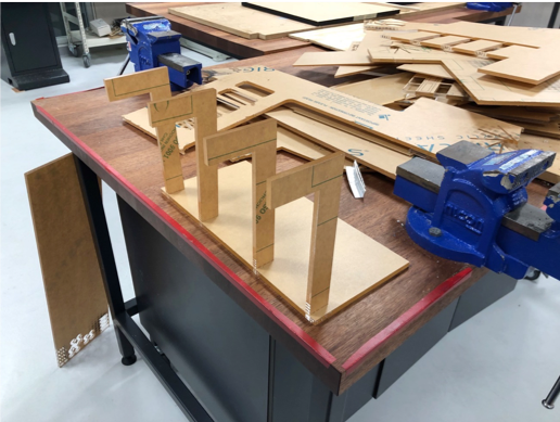

I am trying to overlay a simplified (laser-cut acrylic sheets) real-world-mockup with CAD  data.
With just one ThingMark, I experience problems with occlusion by my mockup.

    • this is the mockup I am talking about:

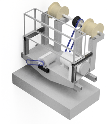

    • this is the CAD part to be overlaid:

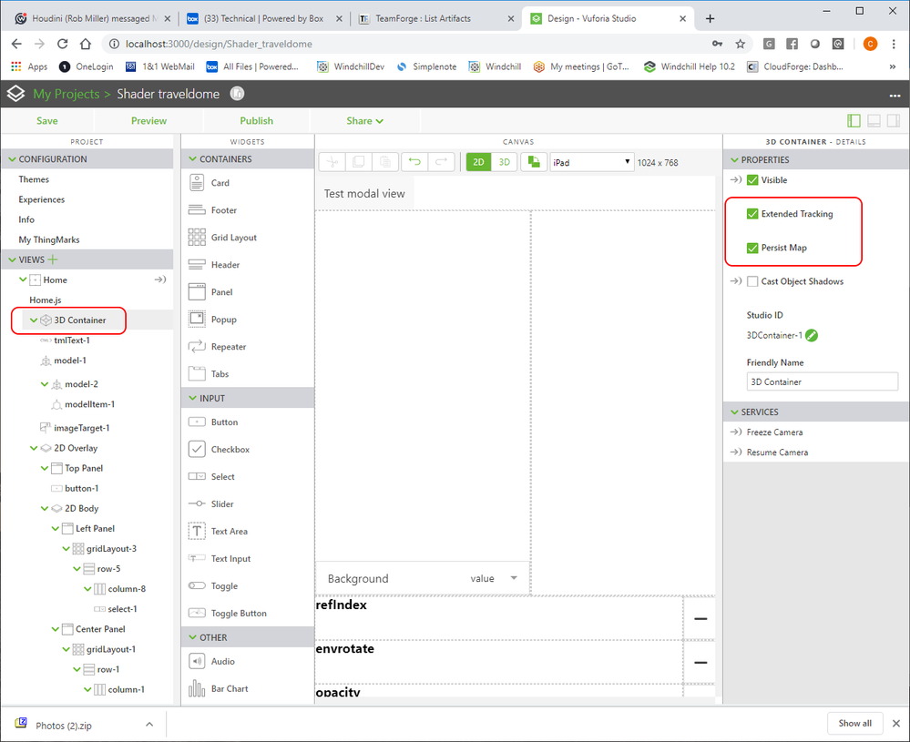

Regarding AR kit, did you make sure to activate "Extended Tracking" and "Persist Map" in your 3D Container properties? If not, switch those on and see if that helps maintain tracking when zooming in on the object.
