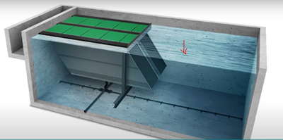

Hi Team,
I was wondering if it's possible to create a water effect on my model, as shown in the picture below. Could you suggest a shader and guide me on how to implement it on my model? I'm not sure what I need to add before importing it to Vuforia Studio. I usually use Creo Illustrator to create animations. Can you please guide me?

Hi @TM_9260611 ,
this is possible if you use some customized /self created shaders based on GLSL
some docs(introduction -first steps) are here:
https://thebookofshaders.com/
https://wiki.delphigl.com/index.php/Tutorial_glsl2
and some examples for water shaders:
https://www.shadertoy.com/results?query=water&sort=popular&from=0&num=12
especially:
https://www.shadertoy.com/view/4slGRM
but also: https://www.shadertoy.com/view/lsXGzH
But as mentioned they could be implemented but possibly they will not work (or will work with bad performance) on the mobile platform in real time render.
Here an example for partially implementation of such example which I used in the past but it has not the best performance and is working on Android but has some graphical issues on IOS:
The example of the shadertoy are a little complex and need to be adapted to Vuforia Studio. But .... a shader which is based on more complex math operations is not so efficient and lead to performance issue - because this should work on mobile platforms
The example  here  uses js code and glsl shader definition in tmlText widget
Here I added a test Studio project, only as example so to see how such shader could be implemented , based on example
So hope will help. t
