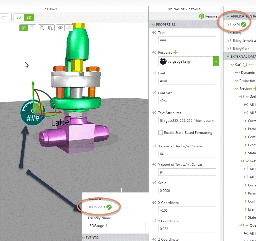

here a very simple example simulating a value:
So following demo project :
In this project I have a 3D gauge "3DGauge-1" and application parameter RPM
Then added the following script:

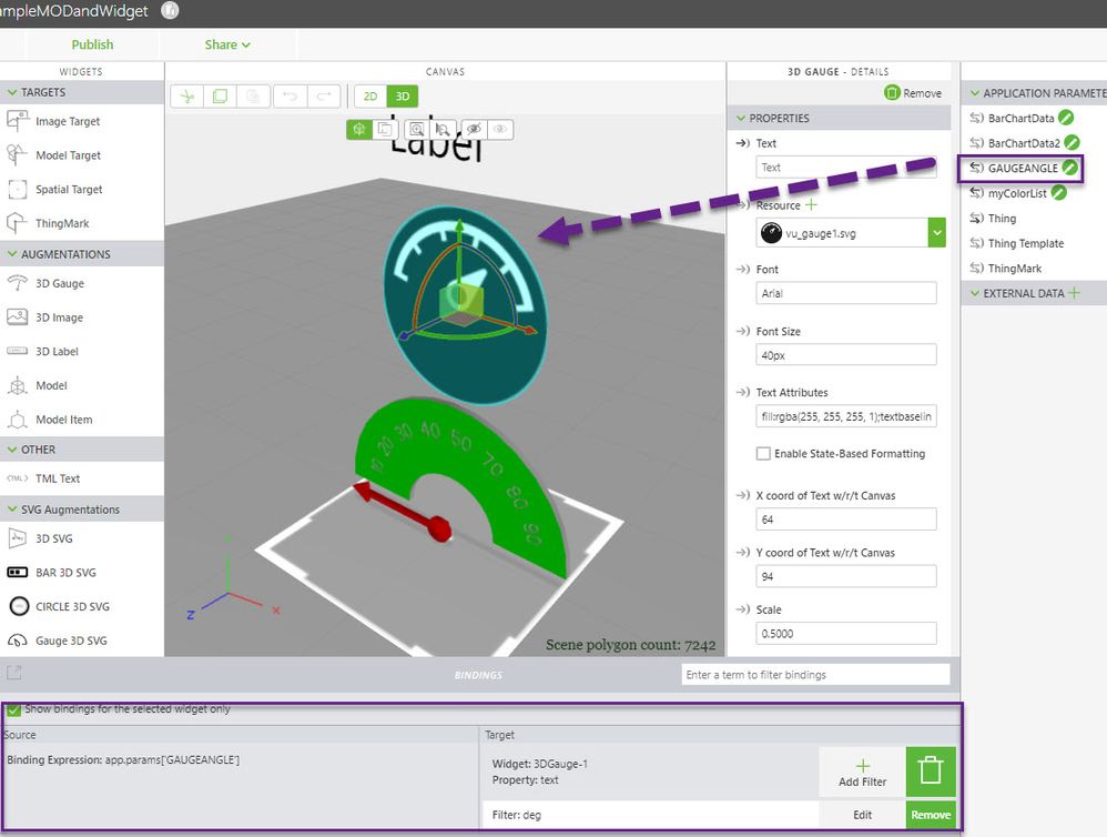

The code will change the value of the application parameter RPM to random value in range 1-100
The interval callback will call the  setRPMValue function every 1 sec

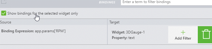

The $watch construct will bind the value to the gauge text property. Of course, you can use direct binding from application parameter "RPM" to 3DGauge-1 .text. In this case the $watch construct is not required e.g:
Additionally, you can add a filter for example to use some units in the display.  About detail for using a binding filter you can see the topic: “Using Connection Filters for state-based rendering and value formatting”

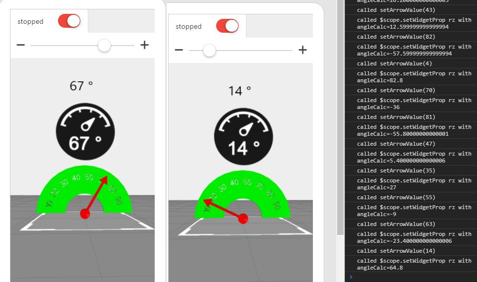

Hi @ranjank ,
so far, I know for the gauge is no direct update service as we know for the chart

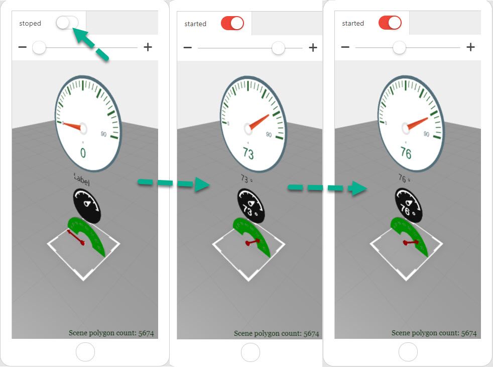

There could be 2 strategies to update:
- set the value to an application parameter and created binding to the gauge:
or you can call after setting of the property the  $applyAsync function - example:
let RandValue= parseInt(Math.random()*90+1)
$scope.app.setArrowValue(RandValue); //set the model gauge
$scope.app.params['GAUGEANGLE']=RandValue //set the parameter
$scope.$applyAsync();

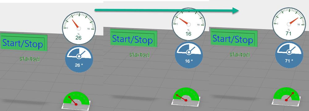

 I attached also a simple Vuforia Studio  project as example:
I added in the example also the Gauge 3D Svg widget(refer to  CS321903 for this extension - widget):
also attached here the updated demo project.
