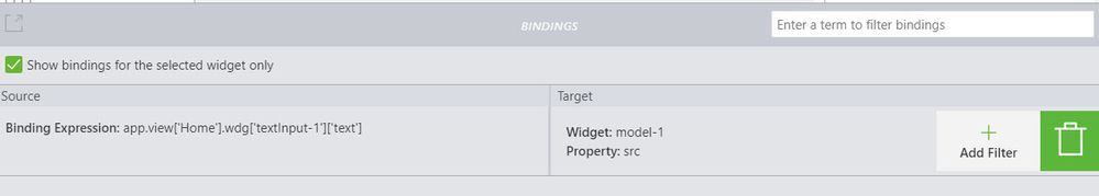

In you code you use resource as property but the property name is src so far I remember. You can simple add a binding to see it :
So that the code should be
   if($scope.view.wdg['Model']['src'] == 'app/resources/Default/fabia.pvz')
or some RegEx expression or usage of IndexOf funciton with the src property.
