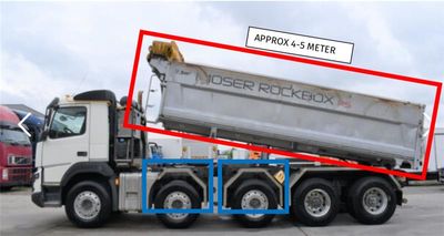

We have a use case using Vuforia Studio in which we need to place a digital model onto a truck, to see if it fits. After the user walks away from the thingmark, there is a noticeable hop, when the user returns to the thingmark and the camera picks it up. This is not precise enough for our use case.
we need to place the AR model of the tipping container (marked in red) (approx. 4-5m long) onto a new truck to see where to mount the side panels, tool boxes etc.
What is the best and proven way to place it with precision through a thingmark?
We are using a Ipad Pro with lidar, the persist map and extended tracking options of the 3D container don't seem to improve the tracking.

The customer does not have the 3D model of the trucks, so we would neet to design and manufacture a part, that will be used for the tracking.
