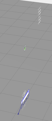

I am also not sure if it is due to the chrome and edge issue, as my 3D canvas is flatten, so i publish with Firefox which i see the error
WIth chrome/edge, my 3D canvas/3D panel is flatten.
Is it similar?
Is it similar?
