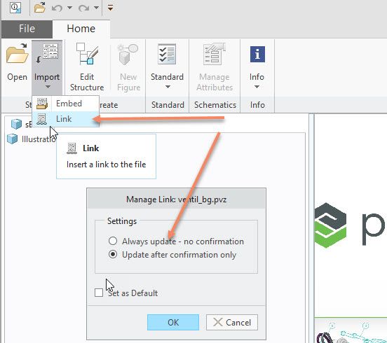

@lcase to better  clarify  the topic I want to point that the alert what you mention - it is  not the default behavior.
To have the alert that the cad data is changed in Creo Parametric  you need to import /load the data as linked data. So far I know when you import the data as embed - then no update is possible.
Here in illustrate the 2 option to import

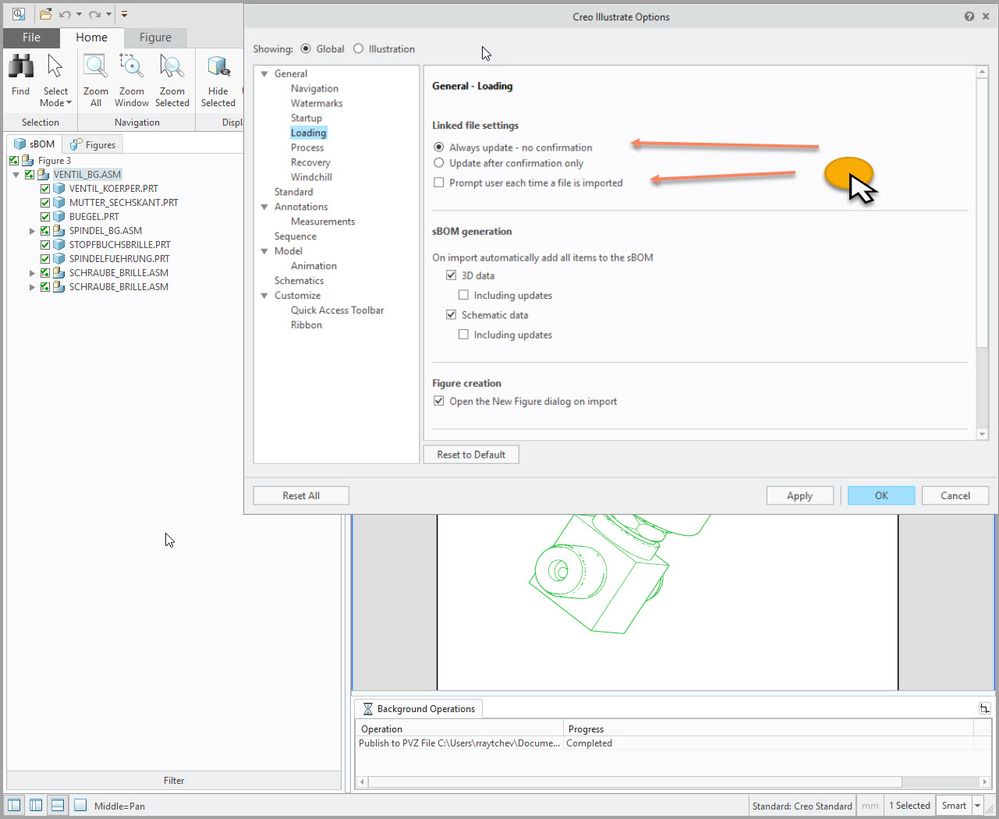

You can later change the behavior by changing the Creo Illustrate Options:
But according my observations it works only if we import a native cad data /asm, prt) It seems that it is not working with pvz file format. I tested it with Illustrate 4.2 and pvz file in linked mode, then modified the assembly and save it again (overridden the original pvz files)- but no notification was received in Creo Illustrate.

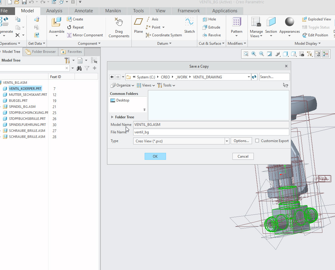

1,)So you can create a pvz file directly form Creo Parametric.

 When export data to pvz Creo Parametric will follow alsways the ID number of the components.
Here and example:

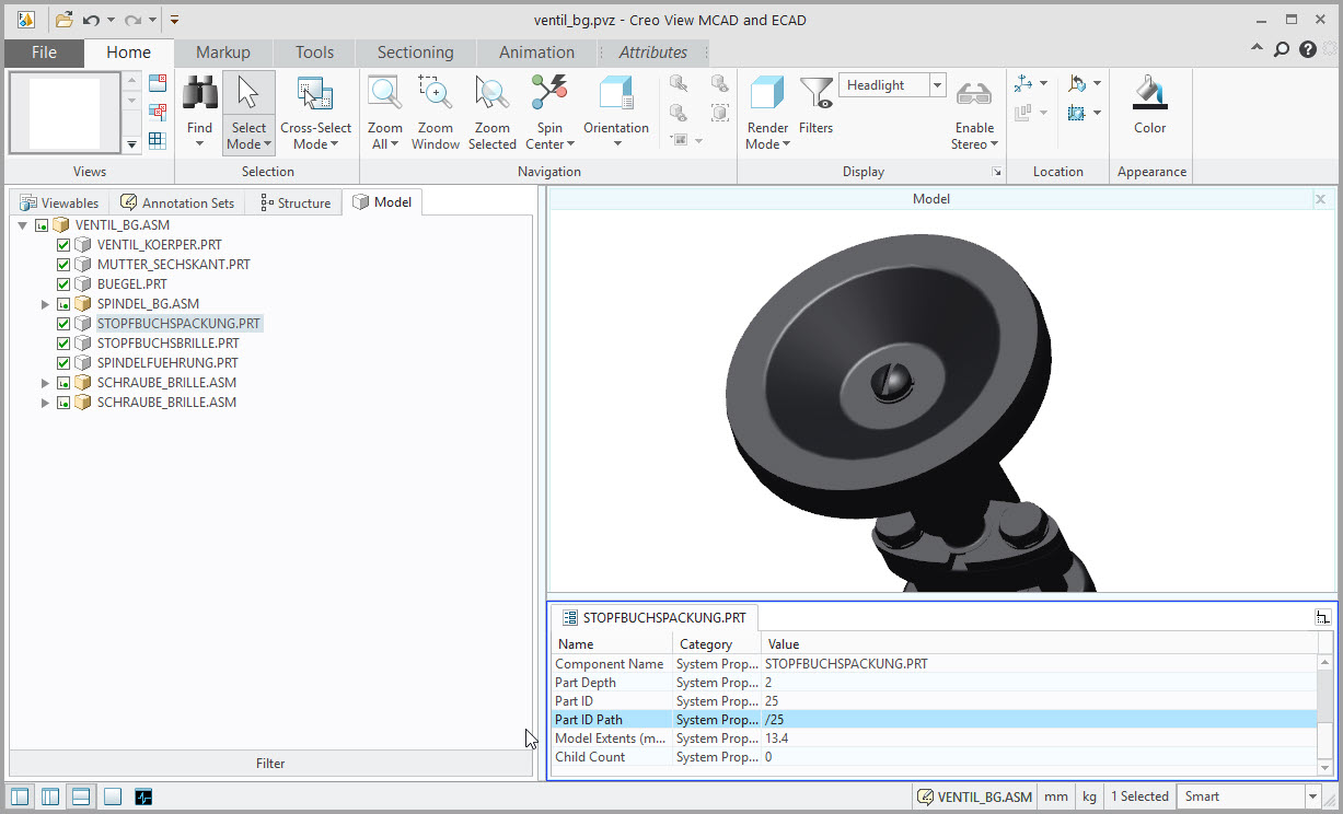

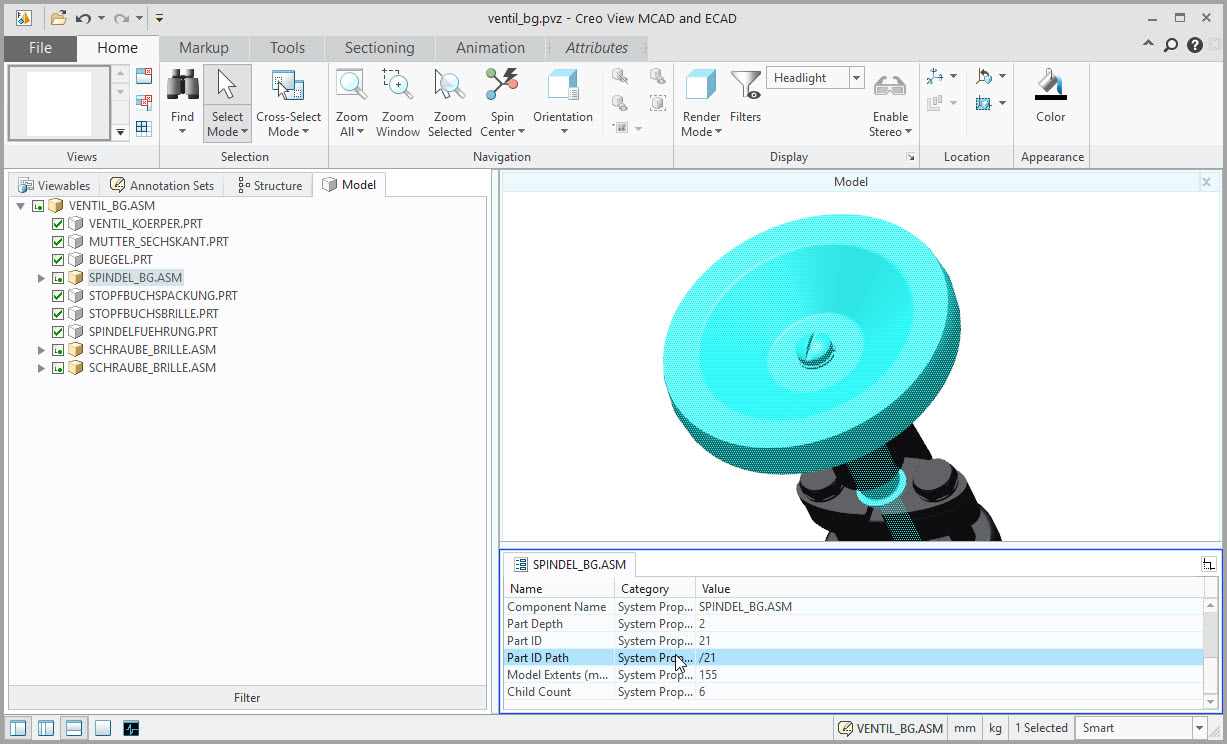

We can see the features ids on left  in the model tree area.  So when we export now the assembly to pvz - and open with Creo View we can find the same ids there and  of course , later in the Vuforia Studio model items:
So here example for 2 components

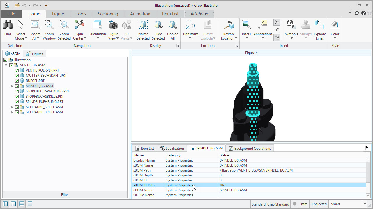

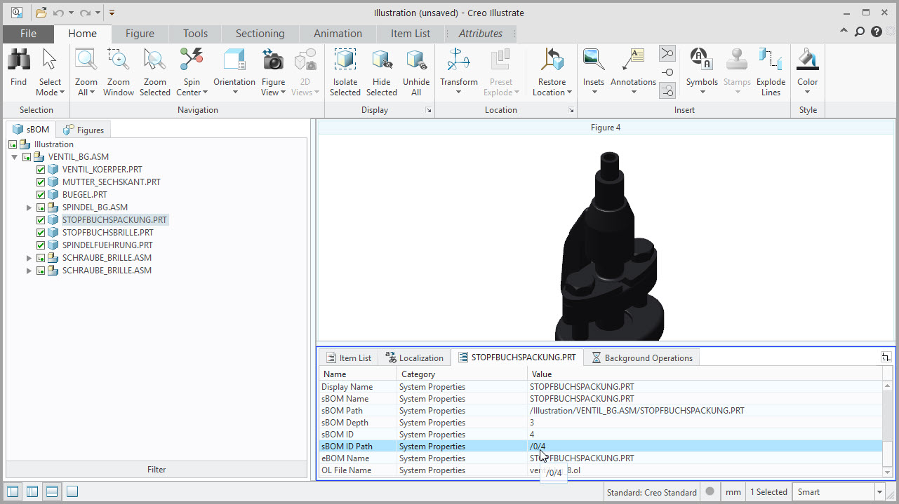

So now when we export the same assembly from a figure in Illstrate we will have diffent numbers for the Part ID Path . So here the same component when published will have als different (to Feature/Component id in Creo) -   "Component Occurrence" later :
So that when we do not use the way via Illustrate but create the pvz file directly from Creo Parametric there you will not "disturb" the structure because it will remain consistent - based on the component ids. - This approach could be used if we do animate using javascript scripts (sample post here. And I believe (did not test it more deeply )  this option could not be used when we have a pvz file created by Creo Illustrate.
