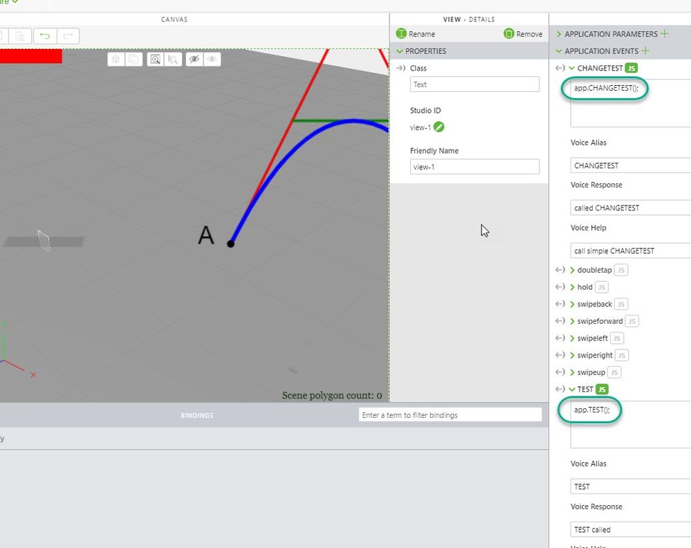

I have an experience with multiple views.  Each view has multiple buttons that call different functions (all of which work as clicks) I am adding the voice commands for the Hololens and I am wondering if it's possible to have 1 voice command defined but have it call a different function based off of which view it's in at the time. Is this possible? I am assuming with js it is but I am not sure how.
I.e I have a Confirm Tare button and a Confirm Weight button on 2 different views.  Each button will call a function that handles visibility of the next button, within their respective views. The service isn't exactly the same, only because of studio ID's of the components in each view.
thanks!

" it's possible to have 1 voice command defined but have it call a different function based off of which view it's in at the time."   so, I think this is possible and could be easy achieved.
In this case you have simple to use always the same function for a specific command - example "TEST" and every time override this function on view load time or also by other event - for example executing "CHANGETEST"
The following example:
project with 2 views on HoloLens : Home and SECOND_VIEW
1.) I defined 2 Application Event/Command: TEST and CHAGETEST:
2.) then I defined in the Home.js the following code:

So here are 2 important points:
-we will define the callback function app.TEST for the  "TEST" command/ event when we enter the Home view.
-The CHAGETEST will modify the definition of the callback function app.TEST
- when we call TEST here we will enter the view SECOND_VIEW. In Second VIEW we will override the function again by other definition (in SECOND_VIEW.js):

Here I used nearly the same code as in the Home.js with the significant difference that when I call app.TEST it will navigate back to Home view.
Here this example should demonstrate that we can:
- use a VIEW specific command
-we can override by runtime the functionality what the command /event do by simple overriding the callback function definition.
