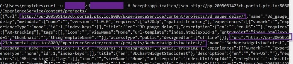

Hi @Martini3119 ,
unfortunately I do not understand what is the goal what you wnat to achieve with your request. If you want e.g. to get some project information
In case that you do know  what of projects are published on specific server – in this case you can call the metadata of all published projects. This will return a json object which also will contains the project name // specific json key property   …  jsonsDataArray[x].url
curl -u Adminuser:Aminpassword -H Accept:application/json https://localhost:2019/ExperienceService/content/projects/
Example:
curl -u TechSupportUser:badpassword12345 -H Accept:application/json http://pp-2005051423cb.portal.ptc.io:8080/ExperienceService/content/projects/
So we can see the response of the call and the returned json object:
When we parse the response /string to json array à JSON.parse()
In this case
jsonsDataArray[0].url = http://pp-2005051423cb.portal.ptc.io:8080/ExperienceService/content/projects/3d_gauge_delay/
jsonsDataArray[1].url= http://pp-2005051423cb.portal.ptc.io:8080/ExperienceService/content/projects/3dchartwidgetstudiotest/
Please, let me know if this was the goal or what kind  of information  (please, provide an example) you wnat to receive in your request? Thanks

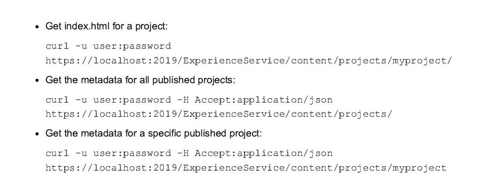

OK, I see -  your are interested on the  publish data. What I could not see what your request where you did received this respond.
I think this output is something what is fix configured on your server. So possibly there is a difference between of the kind how you published the project (public or required authentication) . But I think this is based on the different configuration of the trial and production servers. They are derived from different templates with different requirements for functionality and security.
To request change of  the output behavior  you have to address an case (via technical support case) to the could team where they could check if the desired behavior could be setup
So far I know we have to receive the metadata the following api calls – you can try if this should return the desired information
