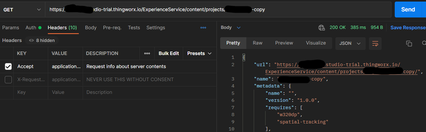

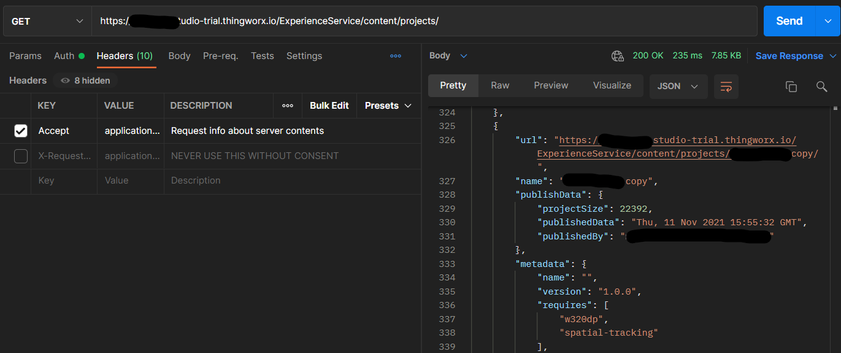

//TRIAL CURL REQUEST
https://XXXXXXXX.studio-trial.thingworx.io/ExperienceService/content/projects/
//COMMERCIAL CURL REQUEST
https://XXXXXXXX-dev.es.thingworx.com/ExperienceService/content/projects/
I just found out that the publishData is only retrievable when the request is performed on the overall projects folder (see test results below).
If I could only see the files inside that folder, that would help a lot. That way I could find out where that information comes from.
