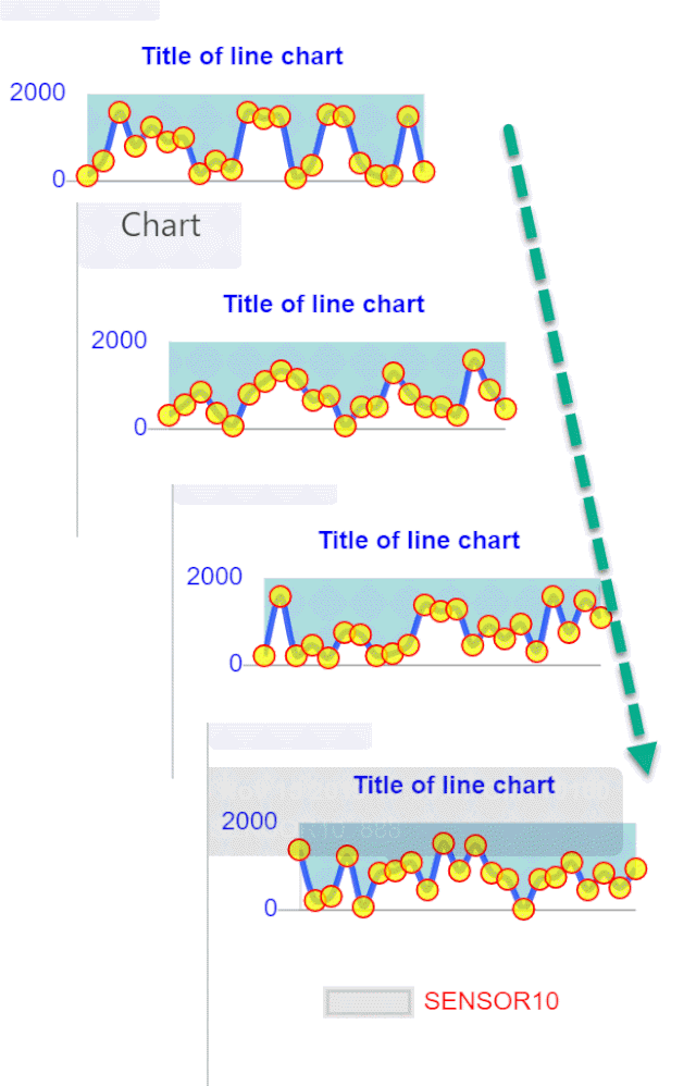

Hi @wxywxy1 ,
so far I see, the question is about the seriesCharts and not about charts in generally? right?
Therefore I will answer it  only  concerning the series charts.
Actually  the normal usage / what is recommended in this case/ -  is the usage of Thingworx data because  in the most cases we will received time series data from there.
Let see the TestThing with a property sensor - which could receive a sensor value in the range form 1-10. The data is logged means contains time series and could be received for particular time range via the service QueryNumberPropertyHistory
We can now write a service e.g.   "getChartDataMinMaxSensor " which return the data as  an InfoTable :
Here I attached  the code which I used  to convert the data - means to change the value field name  to SENSOR10 and to select the time range:

This code returned the dataSet which is displayed in the picture above and we can used it to show this data in the timeSeries Chart  here this is the  Widget with id= "timeSeriesChart-1":

this code will take the data and will do 2 things:
1.) it will reset the value of SENSOR10 to a random value in the range 1-1600
2.) !!! it will convert the time string to a date value using the moment() function. To work dataSeries charts requires this dataType!
wxywxy
(To:RolandRaytchev)
thank for reply
When the code above is executed once, it works fine, but not when there is a real-time update.
