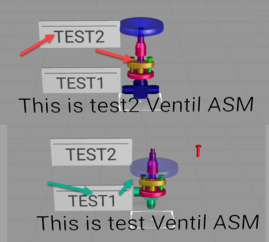

Hi @GianVal ,
could you clarify what means dynamically this case- is the list of widget should be selected dynamically or the data. so reading a json file and setting using a file e.g. json data  is no problem . so far I know there is no general document how to do this but we can find any small example in the different help sources. I did in the past some similar issues in the past. E.g. setting from json file the value of repeater (mobile project test_repeater_dynamic-Elements.zip ) Here the list should be a dynamic value -received from json file. Ok here in this example the json file is fix but it could be also received form any where as json file form upload folder or form TWX repository.
In the second example  here is shown how to read  a json file and setting of values of components widget values (without explicit widget definitions)   (HL attached project propSetComponetsHoloLensExamleCommunty.zip)
of course similar to this  - it will work when we have already widgets e.g. the following code:

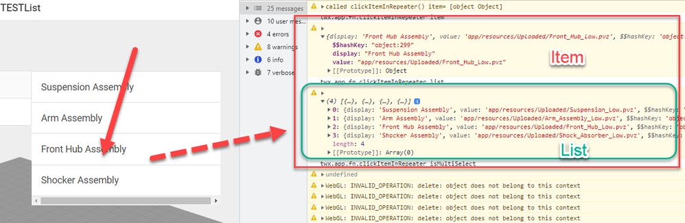

In case that you want to find what is clicked you can use this function (here example only with printings):
twx.app.fn.clickItemInRepeater = function(item,list,isMultiSelect)
console.warn("called clickItemInRepeater() item= "+item);
    console.log("twx.app.fn.clickItemInRepeater item"); console.warn(item);
  console.log("twx.app.fn.clickItemInRepeater list"); console.warn(list);
  console.log("twx.app.fn.clickItemInRepeater isMultiSelect"); console.warn(isMultiSelect);
I found a problem. In the same experience, I have a widget selected. If I choose one of the items in the select widget, the twx.app.fn.clickItemInRepeater function is triggered, but this function is set to be called by the clicked item in the list widget, thus generating a parameter passing error. How to solve this problem? thank you very much
I think the statement "this function is set to be called by the clicked item " is not correct. Possibly you intended to use this function only for specific click on items. But the function will fire on all selection (sometime it is == a click)
So I think you can  check the result  and decide if this is the correct event depending on the value what you will receive. So you will receive the item and the complete list and in the most cases this should be different so that when you test it you could find out what was clicked.
