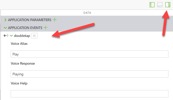

hi, i am doing a hololens project. and i have bind 3D images (play button, stop button) to the animation sequence. How to i create voice commands to the 3D images. For example, by saying "PLAY" and the animation will start playing.

Here's how to add voice commands to a Hololens experience:
In your Vuforia Studio project open the Data panel (the one on the far right), open APPLICATION EVENTS, expand one of them (e.g. doubletap), then you will see the following text boxes:
- Voice Alias
- Voice Response
Voice Commands
You type some text in the Voice Alias and that would be your voice command; upon interpreting your command, the Hololens will say the voice response message.
The Hololens will then proceed according to your binding of that event, or to execute the associated Javascript.

Hi, I tried to follow the steps as you previously described but when I do the binding there are no options for services
So, I'm wondering if there is additional information that I need to feed in...

This is only valid for a AR/3D Eyewear project, not for AR/mobile projects.
Which kind of project have you created? Can you provide screenshots and Studio version?

I created a 3D eyewear project. The version of vuforia studio is 8.3.6.4062

hi @Alessio,
I was binding the double tap with the button, that was my mistake. I made the binding with the model and it's working properly now, thanks!
