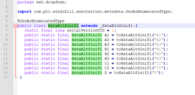

Hi Comunity;
I need to bring the fields in the red box below as a list, how can I do this?

You need to learn how to use IDE with annotations (Eclipse, NetBeans, InteliJIdea atc...)
"_HataAltSinifi" is autogenerated class by annotations.
PTC Supports Eclipse as a IDE that can be used directly with Windchill.

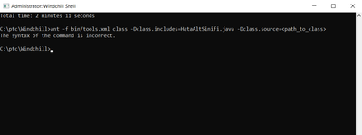

  I tried the steps but I'm having trouble adding the java file do you have any information about it? 

You need to define path to class
the value <path_to_class> is not correct

additional information. The Article mentions that Information Modeler is needed.
InformationModeler is not normally installed with Windchill and it is licensed.
As a workaround you need some IDE as a Eclipse to compile the class with annotations.

What should I do for the _HataAltSinifi and how can I create it?
HelesicPetr
(To:smcvr)
Hi @smcvr
