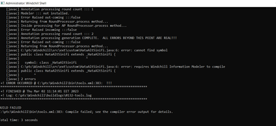

  I tried the steps but I'm having trouble adding the java file do you have any information about it? 

You need to define path to class
the value <path_to_class> is not correct
PetrH
@smcvr
additional information. The Article mentions that Information Modeler is needed.
InformationModeler is not normally installed with Windchill and it is licensed.
As a workaround you need some IDE as a Eclipse to compile the class with annotations.

What should I do for the _HataAltSinifi and how can I create it?

Hi @smcvr
You need to learn how to use IDE with annotations (Eclipse, NetBeans, InteliJIdea atc...)
"_HataAltSinifi" is autogenerated class by annotations.
PTC Supports Eclipse as a IDE that can be used directly with Windchill.
Windchill PLM - Customization with Eclipse IDE
CS63697: How to install Eclipse IDE for Windchill PLM
Using Eclipse
Example Create Pet Class
