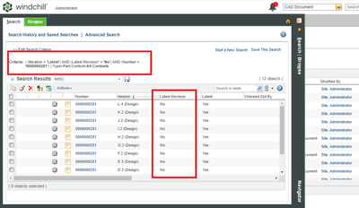

No, I didn't create a product idea.  PTC can't even get 'latest version' searches working correctly (after 11 years and 207 votes).  I just go straight to the database now.  It's pretty easy to construct an SQL query to get anything I need.  Of course that only works for those who have direct access to the database...
18-Opal
August 6, 2021
@TomU

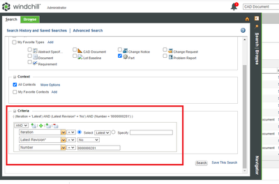

As for the search criteria for Revision = Latest or NOT= Latest,  I have to agree that it does not seem to work.
I think the problem is that while latest iteration (true or false) is stored in the dB latest revision is not.
Interestingly enough the display attribute "Latest Revision" works correctly.
As is the case most of the time, there is a work around for this and yes, it does require some coding.  I won't get into details here unless you're interested.  Below is the input and output.  Seems to work.

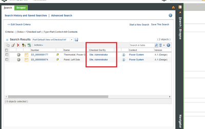

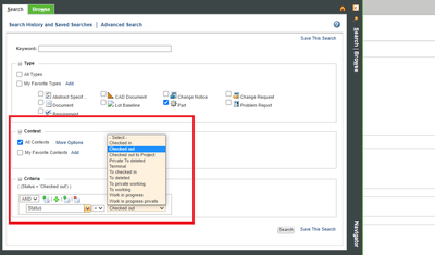

As for searching by checked out, checked in, etc.
See example below. I'm search for any checked out WTParts.
Something like this would allow you to find all checked out EPMDocument from Advanced Search without using Checked Out By
In the example I checked out two WTParts.
Below is the search result.
Note: Checked Out By has also been added to the search results table display.
