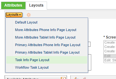

Hi @Amirtharaj_K
Go to the Layout and add the attributes to the Task info page layout
PetrH
