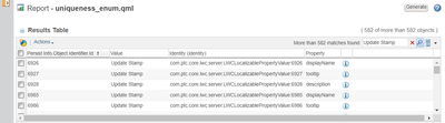

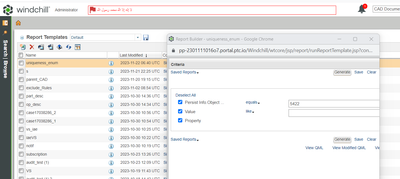

Windchill complains about below entry in DB
LWCLocalizablePropertyValue:5422
you can import the attached qml on the target system and run it with the given id 5422, it should then give better sight in the problematic entry in DB

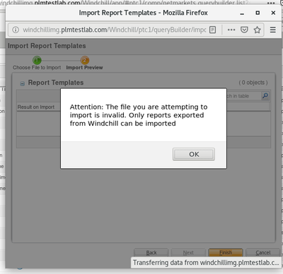

Hi @Fadel ,
Thankyou for your response. I tried importing your attached qml on the target system but I am facing the below error:
Is there something wrong that I am doing?
Fadel
23-Emerald I
(To:RK_10805837)
import as QMl not as template

HelesicPetr
(To:Fadel)
@Fadel
the ootb record with that number is 'Update Stamp' 😄
PetrH

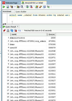

Fadel
23-Emerald I
(To:HelesicPetr)
The IDA2A2 are different from a system to the other on my VM they are 69xx
Fede
HelesicPetr
(To:Fadel)
Hi @Fadel
Yes but it is very low ida2a2 number so I guess that the record is from installation so it is the OOTB enumeration record.
if the source file contains the OOTB enumeration then it could case this problem.
PetrH
Fadel
23-Emerald I
(To:HelesicPetr)
after 12 years windchill, the ida2a2 is still a mystery to me , wcadmin is actually one one of the first objects that are  created and it has ida2a2=2008 , on other VMs it has ida2a2=11 .

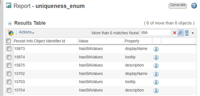

Hi @Fadel ,
Whenever I execute the load command, the value at which the error is pointing is always different. Moreover, when I try to search for the  same value in the report, it doesnt show me any results
Fadel
23-Emerald I
(To:RK_10805837)
Do the given numbers exist in the xml file you try to load ? can you share a copy of that file ?
