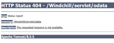

I was referring to the installation of the rest services on the Windchill server as stated in the Windchill REST Services User’s Guide 1.5 p. 11 - Since Windchill 11.0 M020 release is being used "Windchill REST Services [...] must be installed as a standalone with a command line utility"
Nevertheless I've tried to do various GET Requests with Postman, e.g. to http://<PTC_DOMAIN>:8080/Windchill/servlet/odata
However I only get a 404 that the requested ressource is not available (Authentication is correct)Capture.PNG
The Webservice came along with a CPS in 11.0 M030. Before you need to manually install it with a command line script. In 11.1 and newer, the interface is part of the installation.
