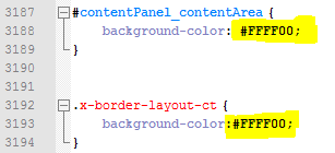

Windchill 11.0 doesn't use images for the background so changing it is actually easier.  Just alter a few values in the main css file:  <Windchill Home>\codebase\netmarkets\themes\windchill\xtheme-windchill.css
For example, try changing the background colors on lines 3188, 3193, and 3288 to #FFFF00 (yellow):

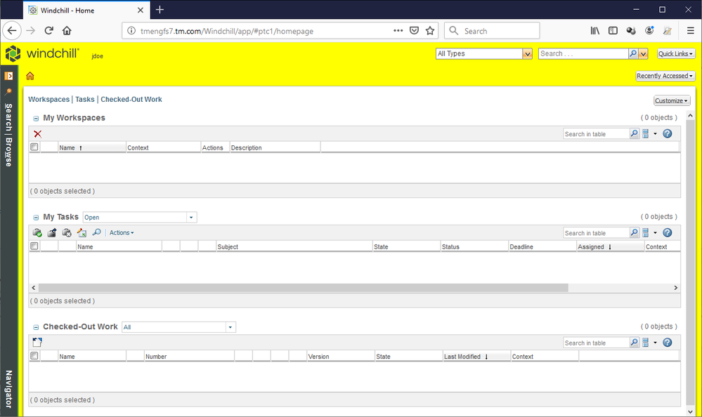

Changing these three values will make Windchill look like this:

I changed the background color on line 3188 to a dark blue (#0000FF).
When I open Windchill in Bing, it did not change the color, but in IE and Chrome it did.
TomU
(To:BenLoosli)
Bing is a search engine...  Do you mean Microsoft Edge?  My guess is that the CSS is cached.  Try reloading the page while pressing F5, CTRL + F5, SHIFT + F5, etc.
BenLoosli
(To:TomU)
Yes Edge!
Ctrl-F5 did it.
