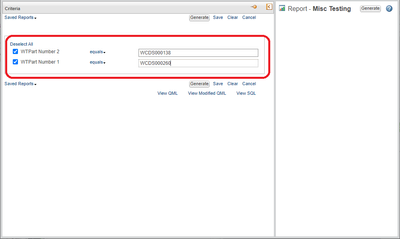

Is this what you're looking for?
I created this query with the Query Builder.
Enter two WTPart numbers
Select Generate
Query returns all assemblies that both Parts are in.
David

YES! This is what I was told is "difficult and borderline impossible".
May I ask for details (I am not the admin, merely a KeyUser) so I can hack'n'botch it with my admin?
