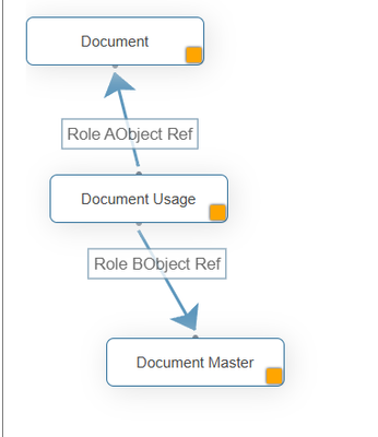

Are you referring to Structured Documents? https://support.ptc.com/help/windchill/r13.1.0.0/en/index.html#page/Windchill_Help_Center/docmgmt/DocMgmtDocStructureReorder.html#
I'm not sure how to get the info from CLI, but there is a "Structure Order" stored on the Document Usage link in the database. It looks like this in query builder:
