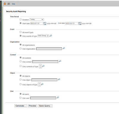

As Administrator, i was asked some KPI about the usage of Windchill Licenses and there are two of them i have difficulties to get for each type of license and during the 3 or 6 past months:
1) The percentage of licenses which are entitled but not used at all.
2) The percentage of licenses which are entitled but not used a lot.
I miss the entitlement date in order to have a reliable percentage.
The different License reports, even the Windchill Performance Advisor don't provide this date.
The objective is to optimize the licenses we allocate
What do you think about ?
Best regards,
Pascal

Hi @Pascal_Brunet
The security audit report with logon and logoff events could also be interesting.
I can imagine that you can create some report with some own counting logic that can count a time spend in the system user by user.
PetrH
Yes you right.
The Audit report with the Event "Edit Group" which is enabled by default in 12.0 is helpful:
I will export data and combine them with other.
Thank you for your quick support.
