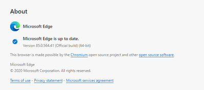

aacciano3
(To:LawrenceS)
Edge update was just pushed out:
Wow, Just is right!  Thanks for the notification.  I just tested and now it works correctly in Chromium-based Edge too!
