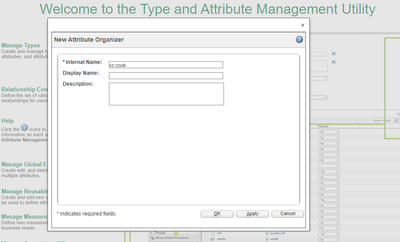

It is frame window inside browser window, it could be created by javascript.
Anyway this window is opend if you want to create attribute in a Windchill type&attributemanagement and others many places as change management wizard in the Windchill.
Screenshot is attached

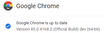

Hello Jeff,
I tried the dev version of chrome 85 and the latest build also has the issue.
 I attached also video where the history had been cleaned.
Thanks. Will update after comparing this version with the build that R&D validated against.
