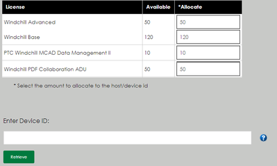

So Licenses cannot shared between Windchill instances, as each instance is a "Site" where licenses are allocated by system ID. The licensing mechanism is built into the web application. That being said, in the license management portal you can allocate a certain number of each license to a specific host, which would allow you to use that set of licenses so support two production instances on one buy.  So if the company has 200 licenses, and Division A needs 80 and Division B needs 110, then you should be good. Please note, if there are users that need to access both, they need a license for each production instance.

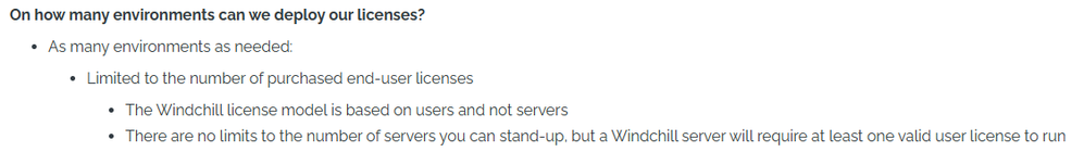

To be clear, it doesn't matter if the same user can access the different systems at the same time or not.  You could have 100 windchill servers and the same user logged into all 100 of these systems simultaneously, and that user still only requires one license (as long as these systems are all part of the same organization.)
It's NOT okay to attempt to use the same license for same person who is doing work for different organizations. A user is not uniquely global (anywhere on earth), they are only unique within an organization.  If the same person is working as a subcontractor for two different organizations, each organization must have their own separate license for that same physical person.
TomU
(To:jbailey)
All licenses available in the allocation table can be assigned to every Windchill instance.  There is no limit on the number of Windchill instances a company can install, and all users can exist on every instance.  It's the customer's responsibility to make sure the same license is not assigned to two different individuals within the same organization.  This is clearly stated in the licensing basis agreement (unless the organization has some other legal document that supersedes the normal agreement.)
https://www.ptc.com/-/media/Files/PDFs/legal-agreements/licensing-basis-table/PLM/licensing-basis-document-plm-5-10-2023-en.pdf
Article - CS277468 - FAQ : Licensing for Windchill (ptc.com)
